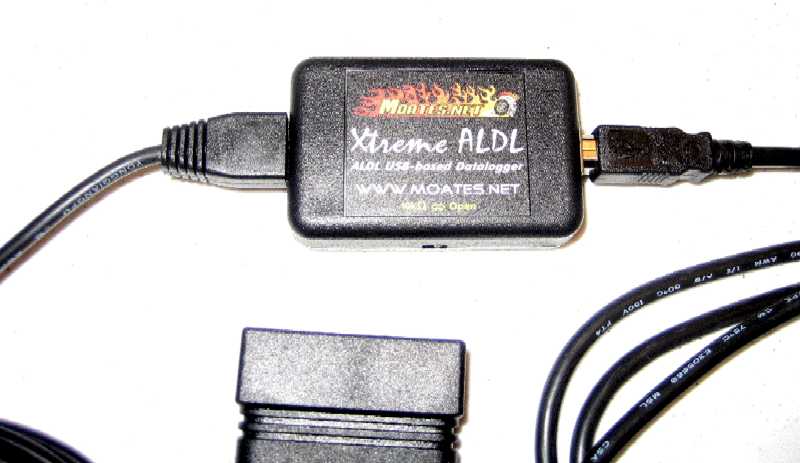

    Cable...

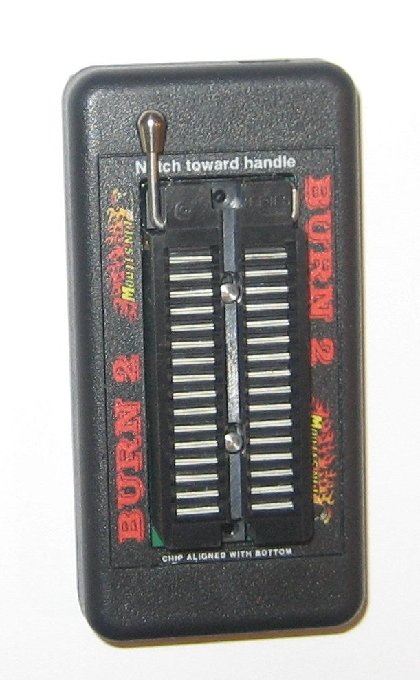

    Burner...
    USB Chip Programmer works with the AT29C256, 27SF512, and AM29F040 chips. Self-powered from the USB port, so no power adapter is needed! Burner can also be used to read stock GM memcals using the HDR1 adapter. While it will only program the three types of chips listed, please note that those three chips can be used as

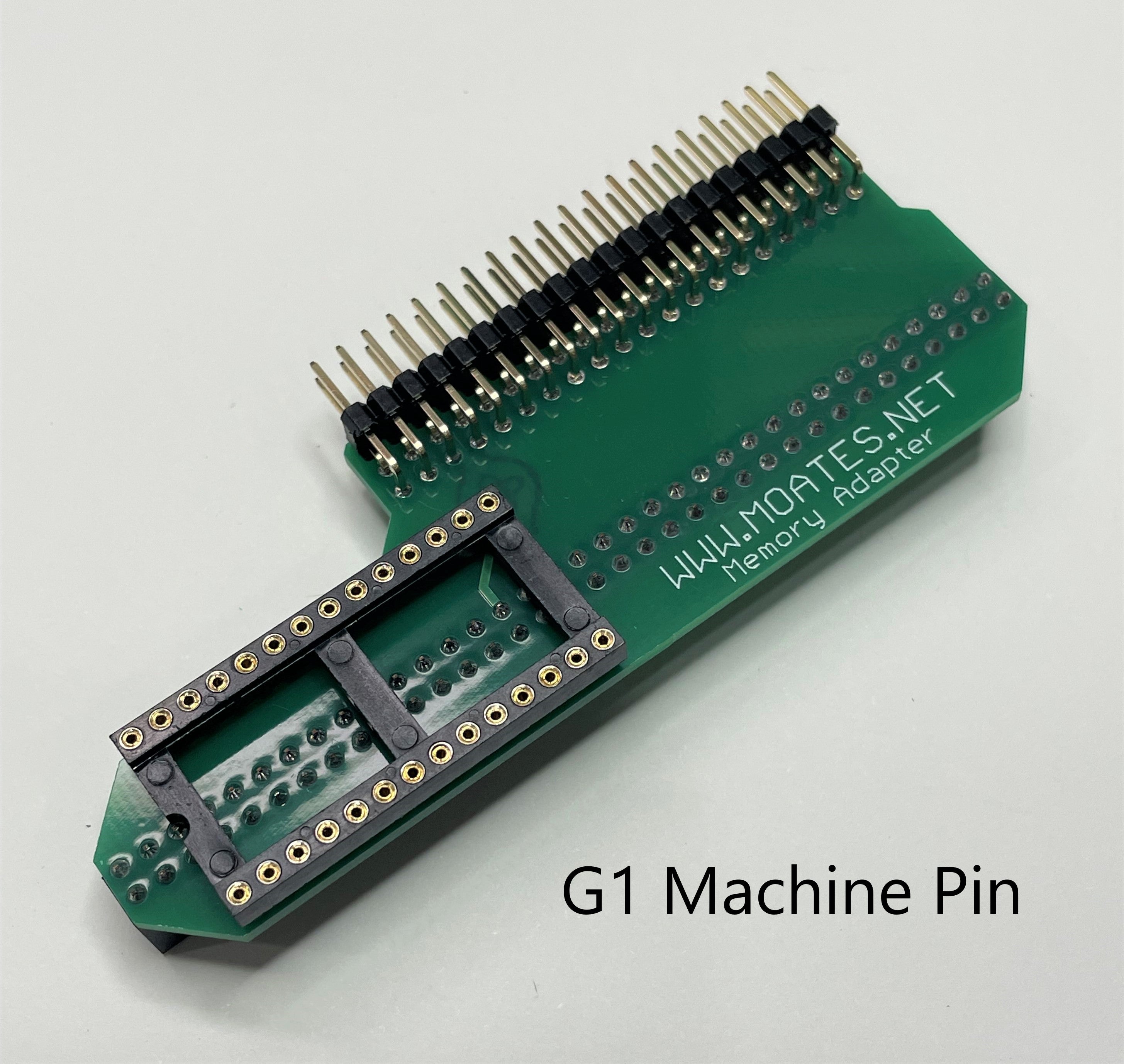

    Here's the G1 (you will need chips and might want the header to make programming easier)...
    The G1 adapter bypasses your factory tuning, and lets you insert your own custom programmed chip without tearing up your stock memcal. Works with a wide range of GM chipped EFI applications, namely the 1986-1993 TPI & LT1 and the 94/95 TBI trucks. Note: This adapter is now available with socket-style options. The d

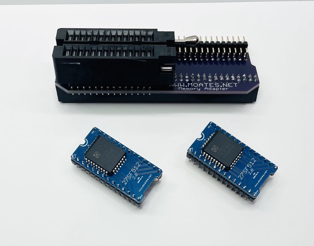

    But you get 2 chips with this socket free (and don't need the header since it's easy to pull the chips)...
    This package is very popular. It comes with two SST27SF512 2.0 chips, an 'S2' ZIF socket, and a G1 adapter! This is everything you need for TPI/etc chip adaptation. If you want different chips or different socket, just purchase the pieces separately from the other items listed.

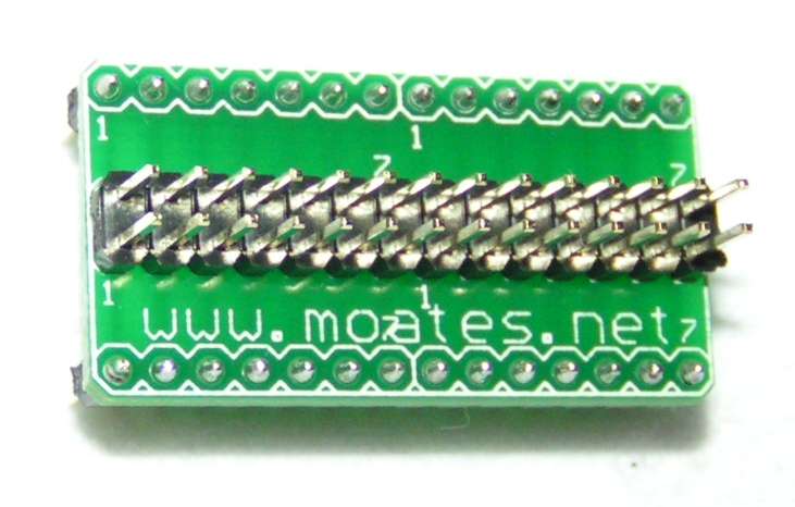

    Header...
    Use this adapter to read the 'stock' binary from your TPI-style Memcal. Plugs into your 'stock' P4-style Memcals. Allows you to download your original 'factory' chip contents directly using a chip programmer/reader like the BURN1 or APU1. Very durable, and designed for repeated use.
