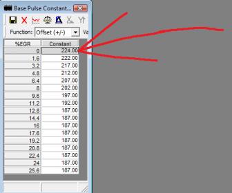

    OK, so i want to keep a running list of things that i already have modified on the .bin that will help stabilize my car even before putting in the new PCM and data logging.
    This list is also to remind myself (because i'm learning from scratch) why we are doing these changes.
    1. Using Isaac's formula we determined that the BPC is 210 at 0% EGR with the new 19 lb. injectors and my 3.4 block so we changed the BPC to 210 @ the 0% cell. I'm assuming this will help right off the bat in regards to the uber rich AFR i'm getting right now. Now that my PCM knows how big the injectors are, it can only help right?
    2. To keep the BPC consistent we essentially disabled the EGR by turning it's "turn on temp" to 151* celcius (303* F) so it will always run in the 0% cell.
    3. Based on my camshaft we decided to up the fuel 10% or so in the upper rpms as to not go lean. This was done by changing the Base VE tables and adding 10% to the 3600 and up rpms cells.
    4. Because my hypertech thermostat is 180* instead of the stock 195, I changed the rad. fan turn on temp to 193 * and changed the fan turn off temp to 181* which should help keep it running nice and cool.
    So now, what else can be done to the .bin prior to running it in the car and modifying?
    Robert, you said something about taking an "educated guess" at the VE. Is this something we want to touch now, or wait until data logging? Any thing at all I can work on BEFORE the first datalog? And also, what are the first things we want to tackle AFTER the first datalog?

    Roberts $a1 .xdf with John's .bin:
    Thats how i've decided to go about working on this tune.
    can you guys check my latest screen shot and let me know if everything looks ok??
    from left to right: BASE VE raised 10% from 3600 rpm and up, Minimum coolant temp for EGR set at 151* C so it always stays in 0% mode, Base Pulse Constant set to 210 (for my 19 lb injectors) in the 0% cell for previously stated reason, Fan turn on/ turn off temps 193* ON/ 181* OFF (set for a 180* thermostat)
    sorry for all the questions, but if this looks ok to you guys then i'll save that .bin and have my first modifications on my tune done!!

  • tkoforpresident
    replied
    sorry.. .it's a bit hard to see the #'s, but let me know if i'm doing this right.
    I've got from left to right the BASE VE changed with the 10% difference, the BPC set at 210 @ 0%, and the EGR coolant turn on temp at 151* Celcius.
    Leave a comment:

  • tkoforpresident
    replied
    this should help. since you don't have EGR going, the only cell you need to worry about is cell 0.
    I thought i had to "disable" EGR first? Have i done that yet? edit: is it the "rpm below which EGR is 0%" cell that i need to make an impossible number to keep EGR in "0%" mode?
