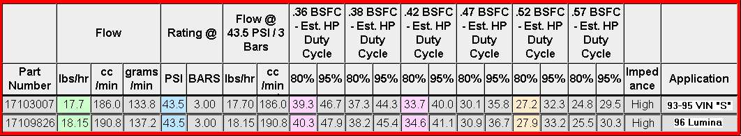

    The only other mod I was toying with was using the EFIs from a 1996 Lumina that deal out 18.1 PPH (17109826) and they have all the other stats as match to the bone stock (17103007) EFIs.
