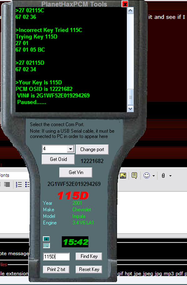

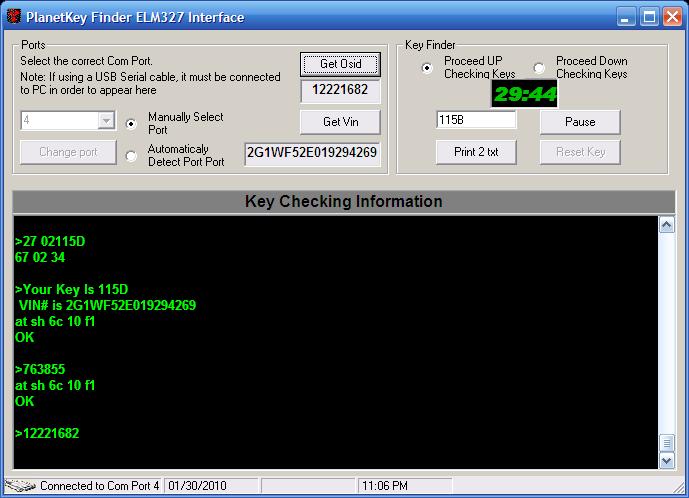

I think OSID is Operating System ID? I know it is the PCM ID
example = the OSIDs that DHP supports http://spreadsheets.google.com/pub?k...n1_K034oyJoMUQ
My OSID is 12221682 which is if you look at that chart from a 2001 3.4 Impala, which is what I got the PCM from.
I am inputing some different commands here and getting some interesting results.
The Elm327 doesnt do highspeed so thats next on my list, but I am going through some commands that a found in the HPTuners archive
Without HighSpeed I know I can not flash, but hoping to be able to dump the bin from PCM with the Elm327Make sure key is on Position, engine off.. and enough battery power.

Uploaded at
Need to clean up code and comment then I will upload source as well.As of April 2
