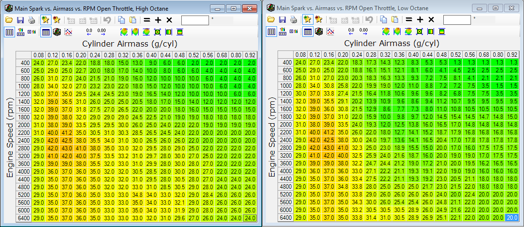

Here, found a custom tune 3400 with a 5-speed (no boost). The spark is a bit aggressive though so you may want to pull it back some or be sure to run high octane like 93.
Last edited by TGP37; 06-24-2012, 03:53 PM.1996 Grand Prix | 3100v6 L82 | T04E-50 Turbo | Getrag 282 w/ EP LSD | SPEC-3 Clutch
Running 93 is just a precaution using a new spark map. If you are really wanting to tune for more power, using 93 would be a good idea as it allows more spark advance. What ever octane you want to use steadily, tune with that same octane rating.Originally posted by ga2001532 View Postthat is pretty similar to what i have now, it just has some higher by two in the high octane tables. Would i really need to run 93 with it being not much of a change. what program are you using to show the tables like that?
For me, spark tuning was after I got my MAF, VE tuned up. And it shouldn't be a lot of change. Mostly you want to gently advance the spark in the top end. Raise 1 degree at a time and log a 20+ minute drive. Reduce spark where you get KR by 1/2 of the reported KR average in that cell. Repeat but this time don't raise the spark where there was KR. Repeat a few times and keep an eye on performance. If you notice it accelerates a little slower or produces less torque, back off. Ideally you want the least amount of spark advance for the plateau of torque. As in, you will reach a max power output no matter how much more spark you add....you want as least as possible advance to achieve that peak torque.
Always save the updated PCM file as a new file, keep the old one in case something doesn't work right. You will be able to back up to the last settings....or view the logs with their respected pcm file for analyzing.Last edited by TGP37; 06-25-2012, 04:27 PM.1996 Grand Prix | 3100v6 L82 | T04E-50 Turbo | Getrag 282 w/ EP LSD | SPEC-3 Clutch
