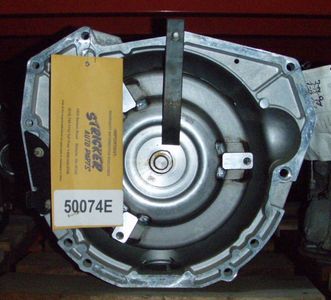

          Obviously, the CTS did not use a FWD transaxle, but the LY7 was used in the CTS as well as many other FWD vehicles. Here is a pic of the CTS RWD 6 speed auto.
          The FWD Transaxle is a little easier to see the bolt pattern.
          Starter appears to have moved also.
            While they do have similarities they are not the same. The obvious is the starter relocation but it also looks like one of the bolt holes is completely missing. I'm sure an adapter plate and custom clutch plate could remedy the problem but that could be said for nearly any engine.
              I'd love to get a photograph of the backside of both engines. The pattern looks close, but almost as if the pattern was rotated slightly counter-clockwise for the new motors.
                The back of the engine is pictured in the other thread and I attached a pic of the trans here. The two bellhousings you have posted look different from each other and very different from the current GM High Feature engines. Believe me if it was as simple as dropping it in with minor modifications I am sure it would have been done by now. I know I would prefer using a newer DOHC as opposed to an old pushrod motor but they don't seem to be very cost effective for swaps at the moment.
