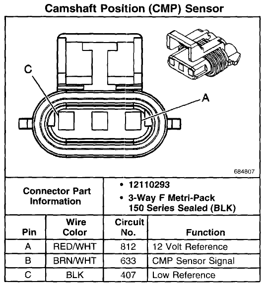

use whatever fits your harness. If it throws a code, then change sensor. But it should be fine either way from what people have experienced.
