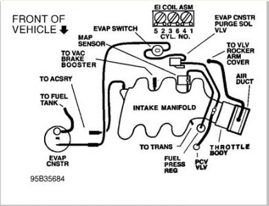

I am swapping a 3400 from an 04 Venture into a Fiero, and would love to have a vacuum diagram to guide me through routing the vacuum lines. I have used the search function...but don't seem to be finding one (although I can't believe one hasn't bee posted).
