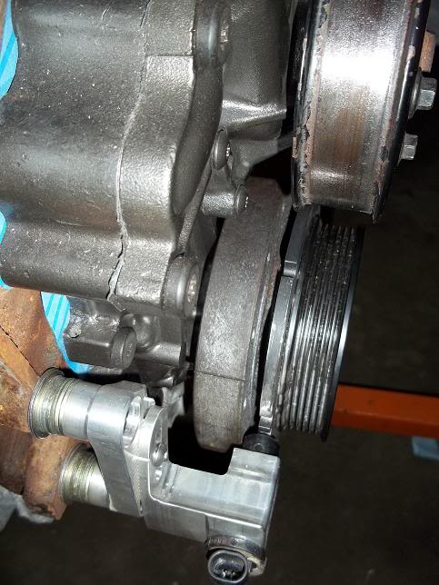

Evolving a little.. just need to order up the parts to make a good turnbuckle and find a belt that will fit. I added in an idler on the other side to help make better water pump contact.
Once it's all finalized i'll cut out some flat plate and make the PS pump bracket solid, right now it's kind of nice to be able to move things around.
