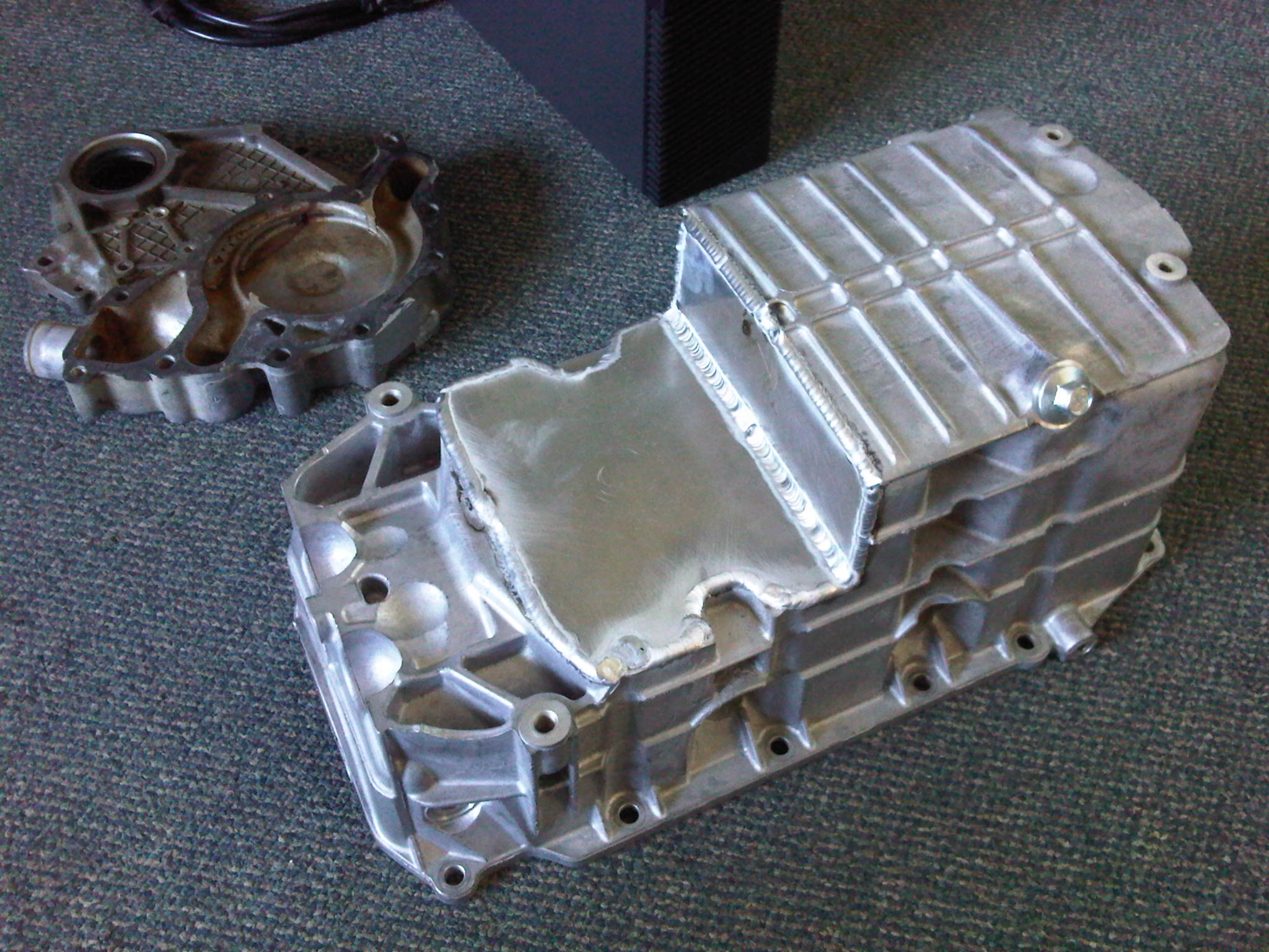

Hopefully this won't leak. Also got the extra hole on the RWD timing cover plugged that would otherwise leak on a FWD engine.

Thats some nice aluminum welding. Did you have it done somewhere or do you weld aluminum?Originally posted by Canyonero View PostHopefully this won't leak. Also got the extra hole on the RWD timing cover plugged that would otherwise leak on a FWD engine.

Very nice welds. Someone has a high power TIG welder and some patience.
By chance is there slope to the pan so the new areas drain back?
I was looking at a similar mod on my 3900 pan but wasn't sure of the results of welding plate to the cast material. If only my welder had 50 more amps.
I haven't TIG welded since high school, this was done by a professional welder friend of mine. The machine shop he's at is really busy, so I try not to bother him with my favor projects too often.
I'll need to get my own welder eventually - just a MIG for starters, but I'd love to re-learn TIG.
Not really a slope to it, I thought about it, but I was trying to cut as little as possible and keep it simple. Unfortunately, I'll have to bother my friend again, still doesn't clear quite how I need it to. :/'98 Volvo V90 - Ford 5.0 swap in progress
What welder is it? I have welded broken rocker shaft bosses on heads with the Syncrowave 300 and didn't have it near turned up.Originally posted by NateD4 View PostVery nice welds. Someone has a high power TIG welder and some patience.
It's a Syncrowave, not sure the amperage.'98 Volvo V90 - Ford 5.0 swap in progress
