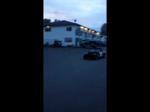

    Of course what's a build thread without a video??

              That video was awesome!

                    That thing sounds mean, lol. I like it.

                            Very cool build.
                            Wonder why some phone videos look so skinny on youtube?
                              Phone orientation when recording?
