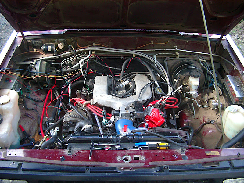

Here is my cluttered engine bay as of this afternoon. I will be very happy when the wiring is cleaned up.
What are the proper wire colors for the heated O2 sensors? I just used black and red, that's what I had on hand.
I'm thinking of using red wire loom when I tidy all this up. Would that be too much red?
I was in a hurry to get my heated O2 sensors installed (had to run power to them). Red and black was all I had on hand to do the temporary wiring.
I'm actually going to take some wiring out of the custom harness too. It has a fuel pump relay built into it which I'm going to remove in favor of the chassis wiring.
