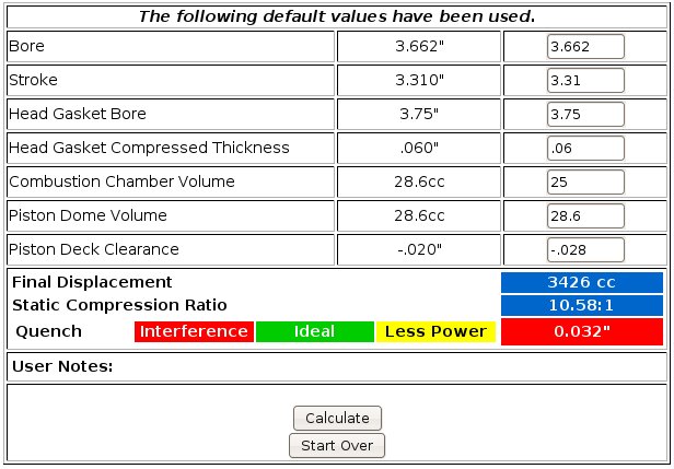

I am having a problem trying to figure the SCR on my engine...it would be .030 overbore, .008 of the block...prob .010 off the heads...3400 heads pnp by Ben with the SI valves...stock rods/stroke...i think i am getting like a 10.1...but help me if i am wrong
Also SCR problem
