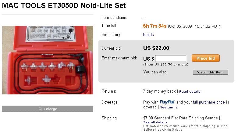

Perhaps these little boogers will help with seeing those micro-second impulses and indicate whether the EFI harness is getting any proper signals from the ECM...? (On eBay ...now)Originally posted by pocket-rocket View PostThey may fire off in ms pulses, but you can still catch them with the naked eye since they fire in quick succession.Last edited by 60dgrzbelow0; 11-01-2009, 12:57 PM.
