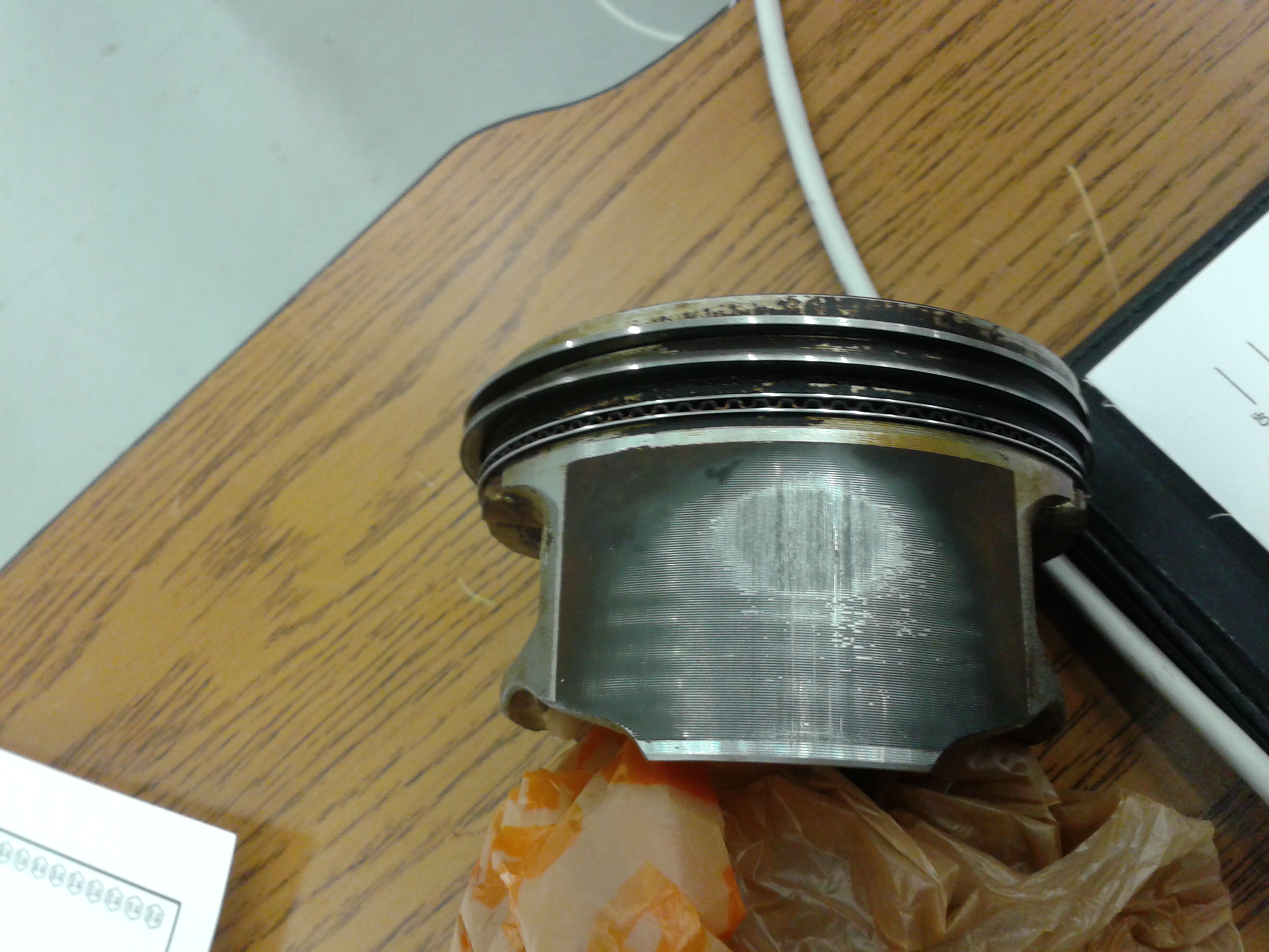

Skirt Thoughts
That is very common for that to happen. I tore down a 60,000 engine and the number 4 looked worse than yours does. I would use it again, a new one will look just like it in a few thousand miles. I would measure the bore, but my guess is that it is just fine. Larry
All the mid to high mile gen 3's i've torn down were like that. The last time i had the pistons out of my 3500 they were pretty similar as well.
I would measure and check it against spec as well, then go from there.
