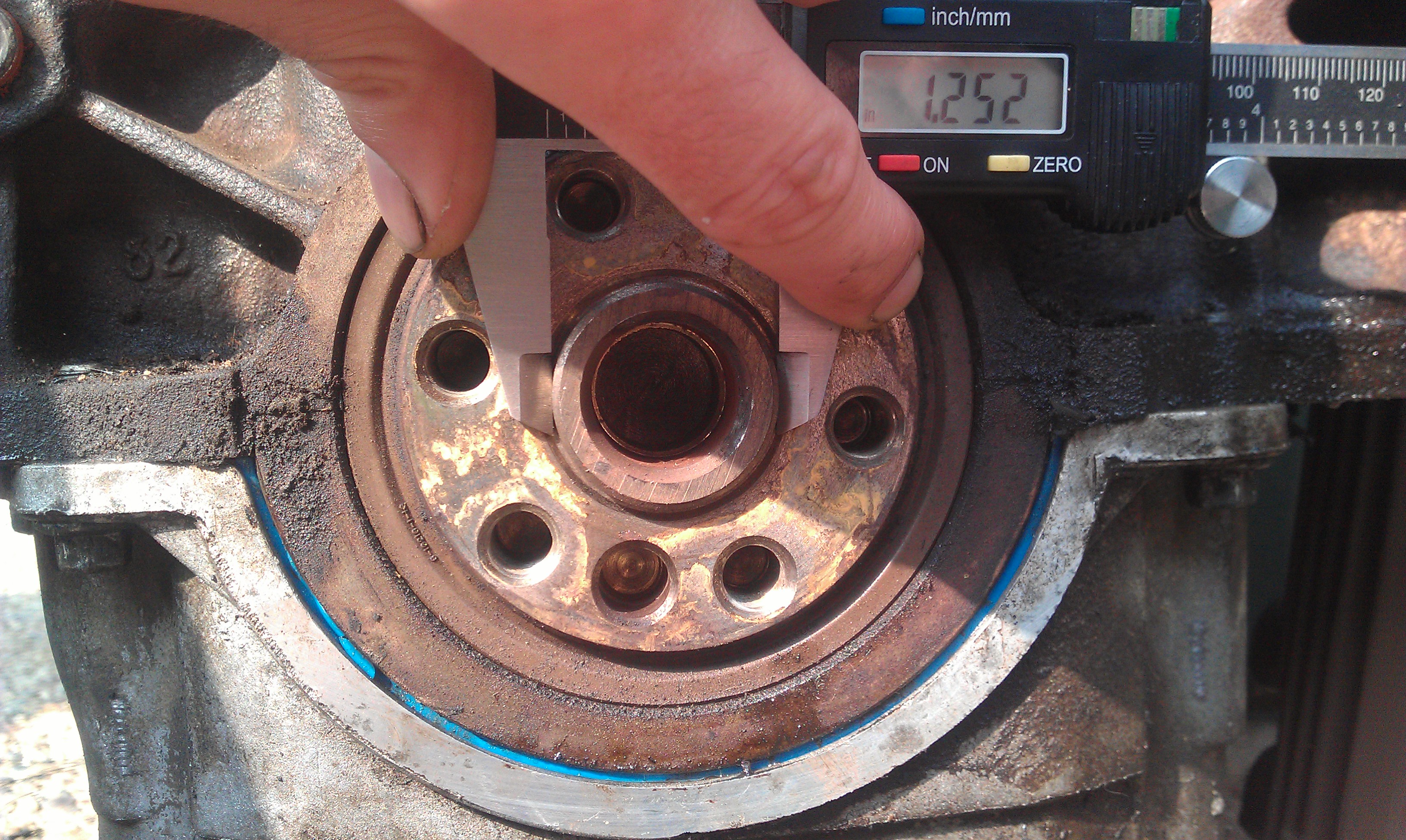

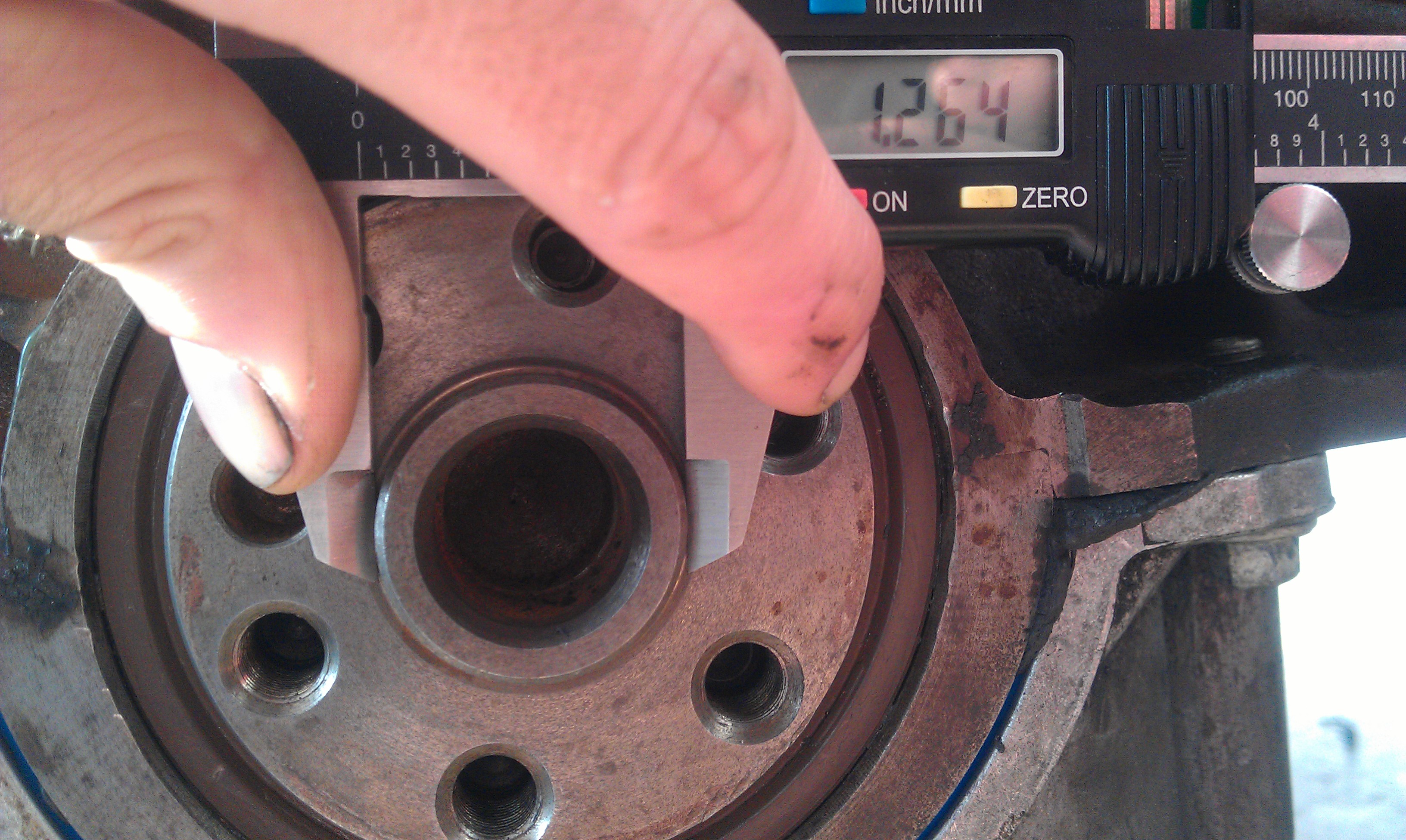

Well, I got everything swapped over that I needed from the Grand Am's original engine (including the oil pan because the rendezvous did not have an oil level sensor -wtf!) Then I got to the flywheel/flexplate. The new engine did not have one installed, so I removed the Grand Am one from the original motor. It does not fit the rear "snout" of the Rendezvous crankshaft? Has anyone ran across this or heard of it? It's a difference of .009-.010 of an inch so I planned on having a machine shop hone out the flywheel hole to fit it to the new engine. Just wondering if I missed something????
