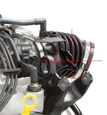

How do you remove the cruise cable from the bracket on a 2003 Malibu with a 3100 engine? Looking at it, it appears that you need to bend the bottom of the bracket, remove the cable, and then bend it back. I plan on doing a cruise control delete, and everything is straighforward except how to get the cable out.

I really don't remember having to bend anything when I removed mine... mine looks the same as yours. I thought there was a way to like turn them and bring them out or something...

I'll see if I can turn it. Why the delete? A couple lbs is a couple lbs. I think I have used my cruise control once since I bought the car...I prefer to have my foot on the pedal.2003 Malibu, 56mm TB, descreened MAF, lower resonator delete, K&N filter, 180 degree thermostat, Dynomax Super Turbo 17675, MRZ underdrive pulley, !EGR, HPTuners, minor weight reduction
Yup, plastic pin, push it with a screwdriver and slide the cable out the side.sigpic

Sorry guys, I was right on this one. I broke the pin after trying several times and it was still jammed in there. I bent bracket straight and it slipped right out. Must be some safety thing they did on newer models in case the pin snapped off. As soon as I bent it straight the cable slid right out. I bent it back in place just in case th throttle cable decides to make a run for it.2003 Malibu, 56mm TB, descreened MAF, lower resonator delete, K&N filter, 180 degree thermostat, Dynomax Super Turbo 17675, MRZ underdrive pulley, !EGR, HPTuners, minor weight reduction
