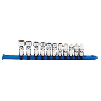

      crow's foot is good, but i use these a 1/4'' 10mm swivel socket.
      top 4 bolts need to be snugged, then snug the diagnal's, then torque the top 4, and then diagnal 4. rocker arms if u have 96 up 3400 or late 99 3100's, then they are self adjusting rockers, just tighten. otherwise buy one of these for $15 and save even removing the rockers to get the pushrods out.
