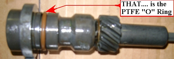

Any chance you were working down below around the Oil Pan Hold Down Bolts and Tabs ... possibly real loose at the very back of the block...right at the rear main crankshaft PTFE oil seal? I'm beginning to wonder if maybe there might be a hole or a crack in the back of the block that is letting the oil squirt out under pressure. If that is what it turns out to be and you can see it to clean it...JB-Weld can come to the rescue. Oh...about the "re-fill" oil...Since you will probably change your oil and filter when you finally solve this problem...the inexpensive stuff is good enough to fill up and top off the oil pan (and then pour out) while you are detecting what is wrong. The "Good Stuff" can go in when its fixed and you hear cheers from all of us as ...."The Crowd goes WILD!" and it's Miller Time...Last edited by 60dgrzbelow0; 07-07-2009, 08:27 PM.
