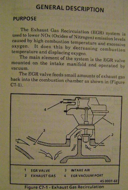

            The detailed reasons are:
            The EGR is designed to introduce exhaust gas back into the intake manifold to reduce high combustion temperatures and the higher ratio of Nitrous Oxide in the exhaust stream.(See Attached Diagram). If any or all of the solenoid actuated metering valve plates in the EGR are stuck open at idle, it will allow enough oxygen depleted exhaust gas back into the intake flow to cause the engine to stall. Since the fuel/air induction in ECM controlled cars is less than solid state like the instant response of a typical Dist/Carburetor engine, think about all the other sensors that have to reach some kind of agreement before the motor will run smoothly... and all are feeding signals to a likely confused ECM unit that is trying to sort out what it all means. So you could have a combination of sensor readings not jibing correctly to suit the "mind" of the machine:
