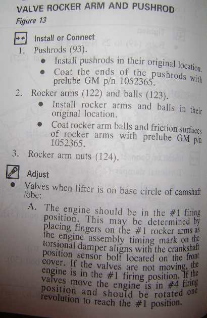

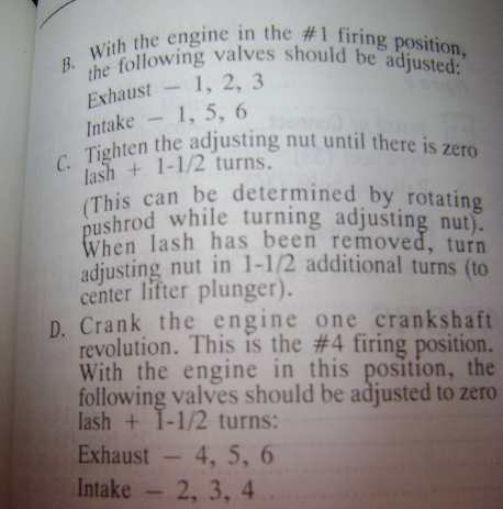

Anyways, I need to go back a bit. Back in late 2005, I noticed I had a compression loss between cylinders 3 and 5 and deduced the problem to be a bad head gasket. So I replaced the gasket, and set the valves. Back when I set the valve lash when I replaced the head gaskets, I used a compression gauge afterwards and got an average of 162 PSI in all cylinders (except for cylinder 6, which has leaking valve guides and was at 180+). A few weeks ago, I started chasing noises again, and one appeared to be loose valves. So, knowing my average compression, I did compression tests again, and noticed that the compression in each cylinder was about 30 PSI lower. I pulled the valve covers, and, sure enough, the valve lash was loose again. I reset it to where I remember setting it when I did the valve covers, and ended up with noisy lifters (1/4 turn past no play, too loose, apparently, but tight enough to bump the compression back up). I just went and set the lash according to the GM FSM for the 92 Bird, which is 1.5 turns past no play, and got a scary noise. I'm going to go ahead tomorrow and check the pushrods for bending and such. The lash spec in my Haynes manual is 1/2 turn past no play, and I've seen 3/4 turn and 5/8 turn from members on this site and others. I'm
In the meantime, I was wondering what the lash spec for the 3.4 and the FWD 3.1/3100 with adjustable valves is? Is there a torque spec for the later adjustable valves, like there is for the 2.2 in the J-body and such (22 ft/lbs)? Or is there another number of turns? I'm trying to find a later spec, hoping that maybe GM corrected it's mistakes some time?
!In the meantime, I was wondering what the lash spec for the 3.4 and the FWD 3.1/3100 with adjustable valves is? Is there a torque spec for the later adjustable valves, like there is for the 2.2 in the J-body and such (22 ft/lbs)? Or is there another number of turns? I'm trying to find a later spec, hoping that maybe GM corrected it's mistakes some time?
... With the valves set according to the manual (set half the valves with #1 at TDC and the other half with #4 TDC), I'm floating valves, no compression at all. I don't know how it started earlier, but it did. I'm going to back out half a round tomorrow morning and more if necessary.
