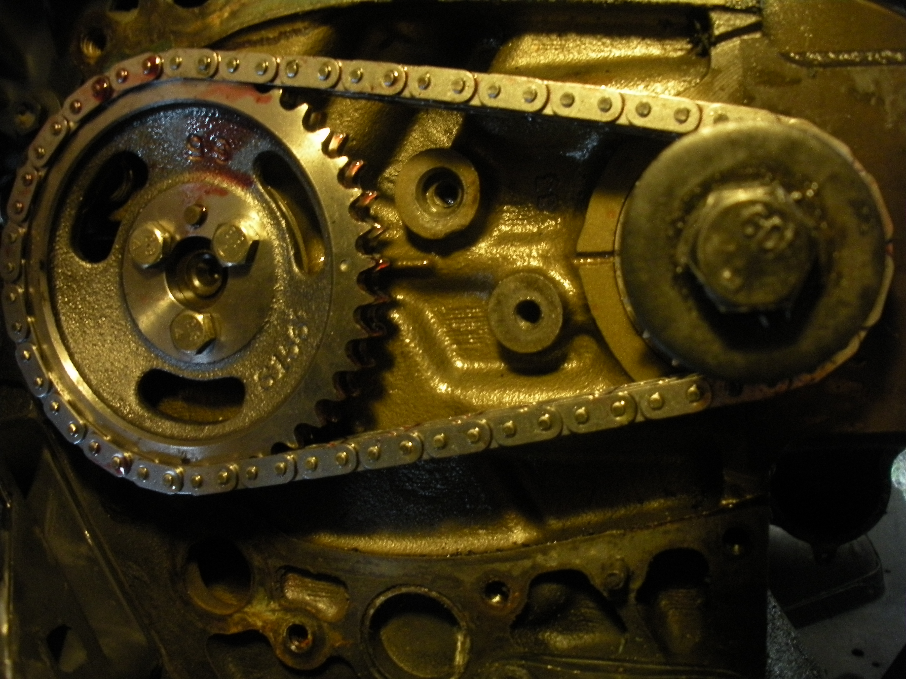

          ok guys got the cloyes 9-3137 set installed today and it is a very nice tight fit made very well i also advanced the cam 2 degrees due to the 1.6 rato rockers that i have already installed now for some interisting news i also bought a new dampener and yes they due need to be modified it needs more clearnce beteween the crank gear and dampaner and between the cam gear and dampener just grab a die grider and carbide tip and have fun just becarfel oh and the nitrous thing ive played with it for about 6 years now and the only motor that has blown on me is when my students decide to keep the button down after they let go of the throttle after the pull on the dyno but what can you do just a small block chevy no loss their lol but i would still welcome any advise knowledge and personall expeirnce hoping to get enough time to get the car finished tommorow

                Birdie... You now have the rather dubious honour of having written a run-on sentence longer than some of mine! And Brother...is THAT ever hard to do!!! Nice work on the build so far and a very clever solution to squeezing in the damper and avoiding those extra long Cloyes gear teeth.
