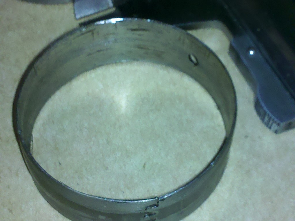

What I mean was which side of the cam has the bad bearings? and where did it break? If there are bad bearings after the break in the cam then yes the bad bearing caused it to break... If only the half that was attached to the timing chain after the break has the bad bearings then that's simply due to not having any oil pressure after it broke and the engine kept running.
Just a quick reply until I post pictures of the old bearings tonight. No doubt the inner bearings were spun. The outer ones have a swath worn to the base metal (copper/brass color) all the way across the bearing's width.
We're the original owners of the vehicle. I've seen pictures of coolant problems due to LIM failure. If there was ever any coolant intruding it was too small to see. Every time I've had the LIM off (3 times now) the gasket surfaces have shown no signs of failure.
I have a feeling it may have been related to wear and oil problems. 18 months or so back the head gasket failed leaking coolant into the #2 combustion chamber only. We took care of that very quickly, I don't think the temp ever got to the top of the normal arc. And probably 15 months ago the p/s pulley snapped so I drove it on short runs with no belt to get it home. It never got to redline temp but who knows, maybe the cam bearings were hotter (high mileage engine) and it set it up for eventual death.
What's left of the cam bearings indicate it was intact and there was oil pressure right up until they spun and caused it to snap.

Well there was plenty of oil and the goo was accumulation at the bottom of the pan. Oil was changed on a regular basis but I didn't save records -- clearly not frequent enough.
To my surprise the filter screen was clean. Just the varnish along the pump and tubing, brake cleaner dissolved that quickly.
The role of the goo may have been to saturate the oil so it couldn't do any clensing. Chaning it would have much less effect of removing the unwanted byproducts.

Another thing to remember, stock cam bearings are nothing special... This is on a decently low mile motor... The rod bearings did not have this type of wear, and this was all stock components.
Copper was also starting to show on the front bearings.

Thanks for the recognition & the cutaways you posted a few pages back. Still waiting on the bearings, they should be in the machinist's hands Monday. Meantime he told me some of the valve seats in the head were loose. Heat seems to be the cause of these problems despite the fact that I thought I didn't abuse it.Originally posted by TGP37 View PostTbay, good to see you can handle this kind of repair. A lot of people just toss their arms up and say, "It's dead"
