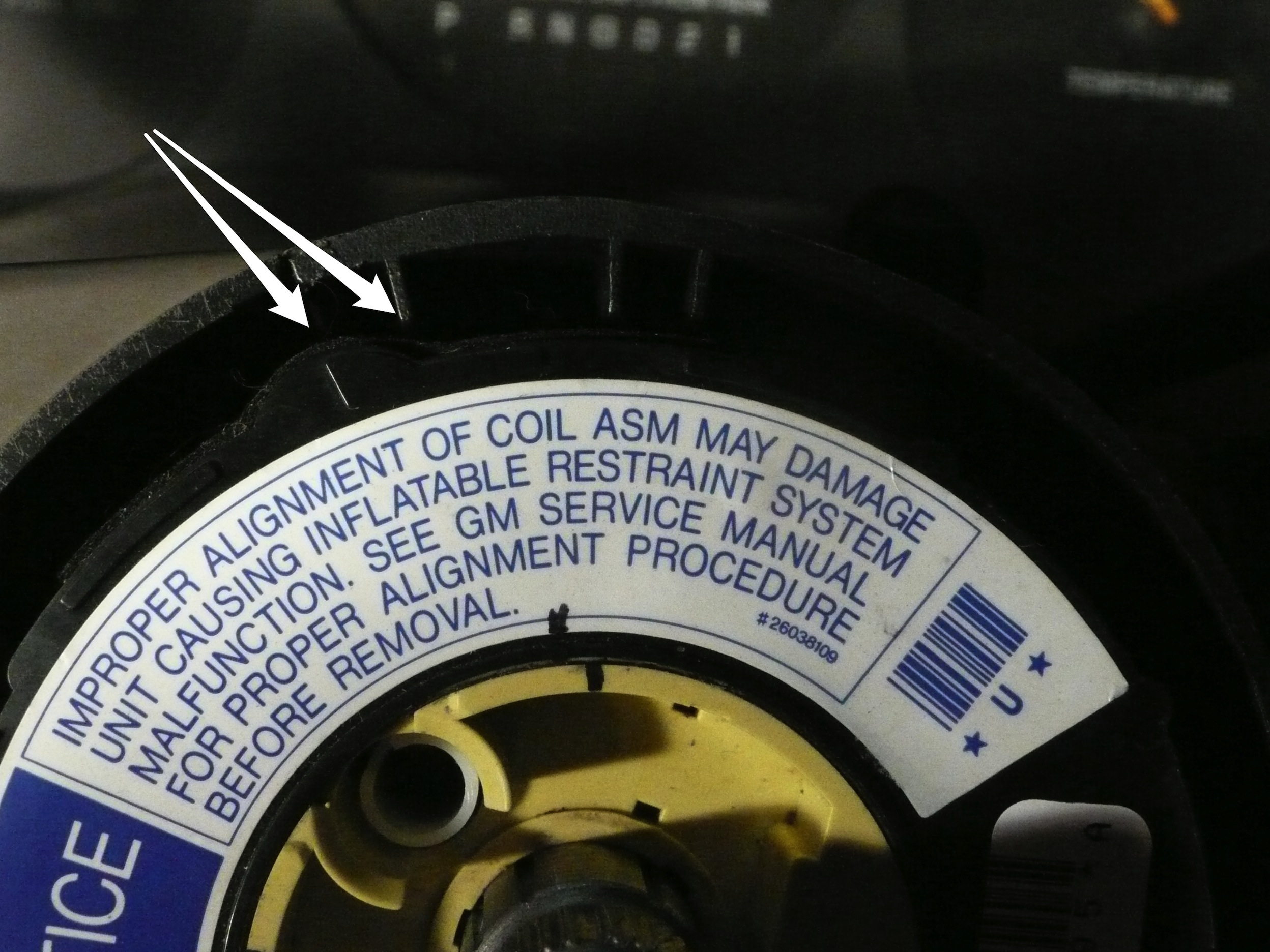

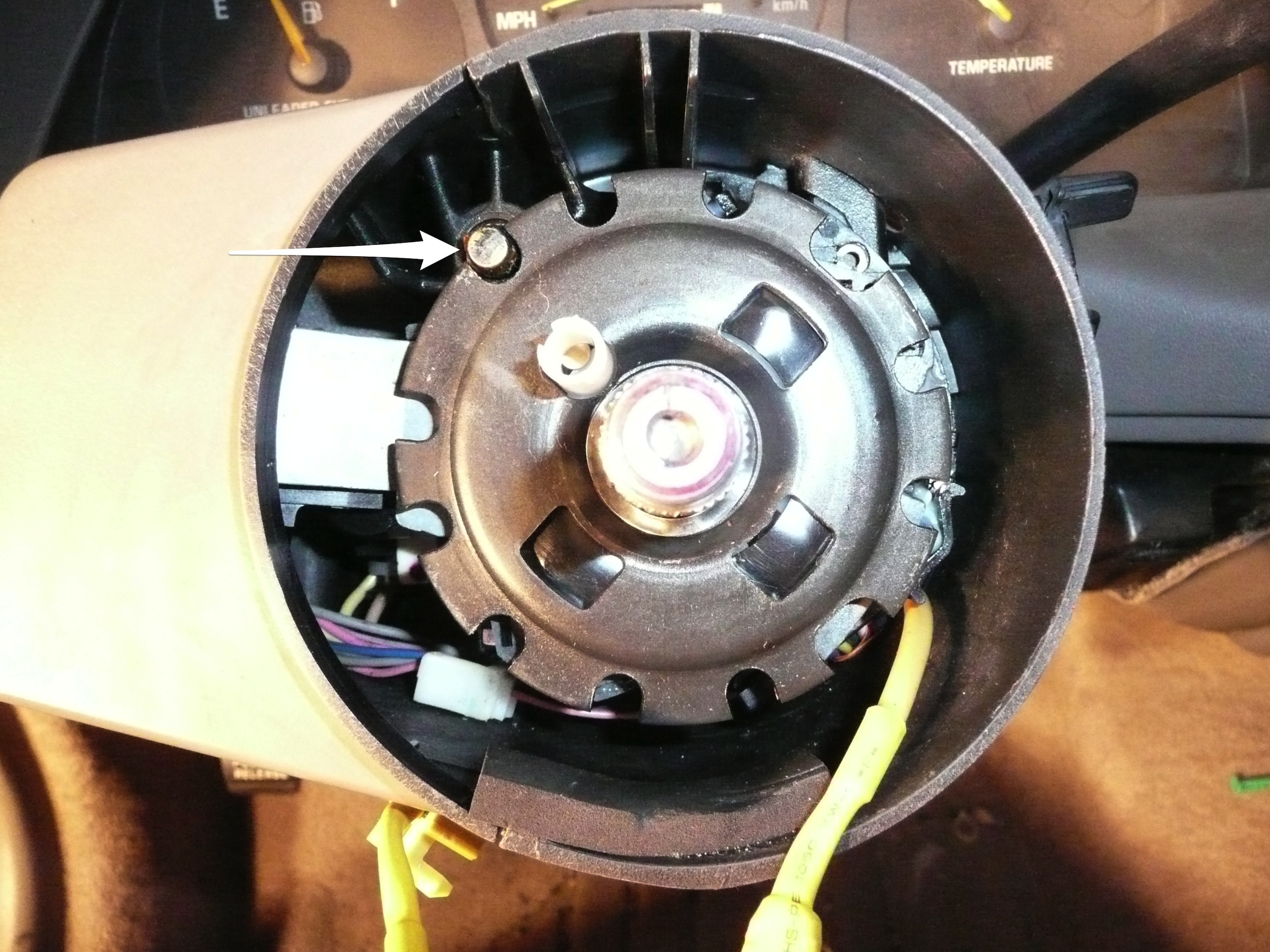

I have just replace the Turn Signal Switch on my 1998 Lumina LS 3100 when I noticed something; luckily, I took pictures throughout the project. After pulling off the steering wheel and the airbag coil (I marked in 2 spots and taped the inner ring because if it moves you have to do a reset), I see the view of the first two pictures where the spring loaded pin on the top left is being pressed down by the lock plate.

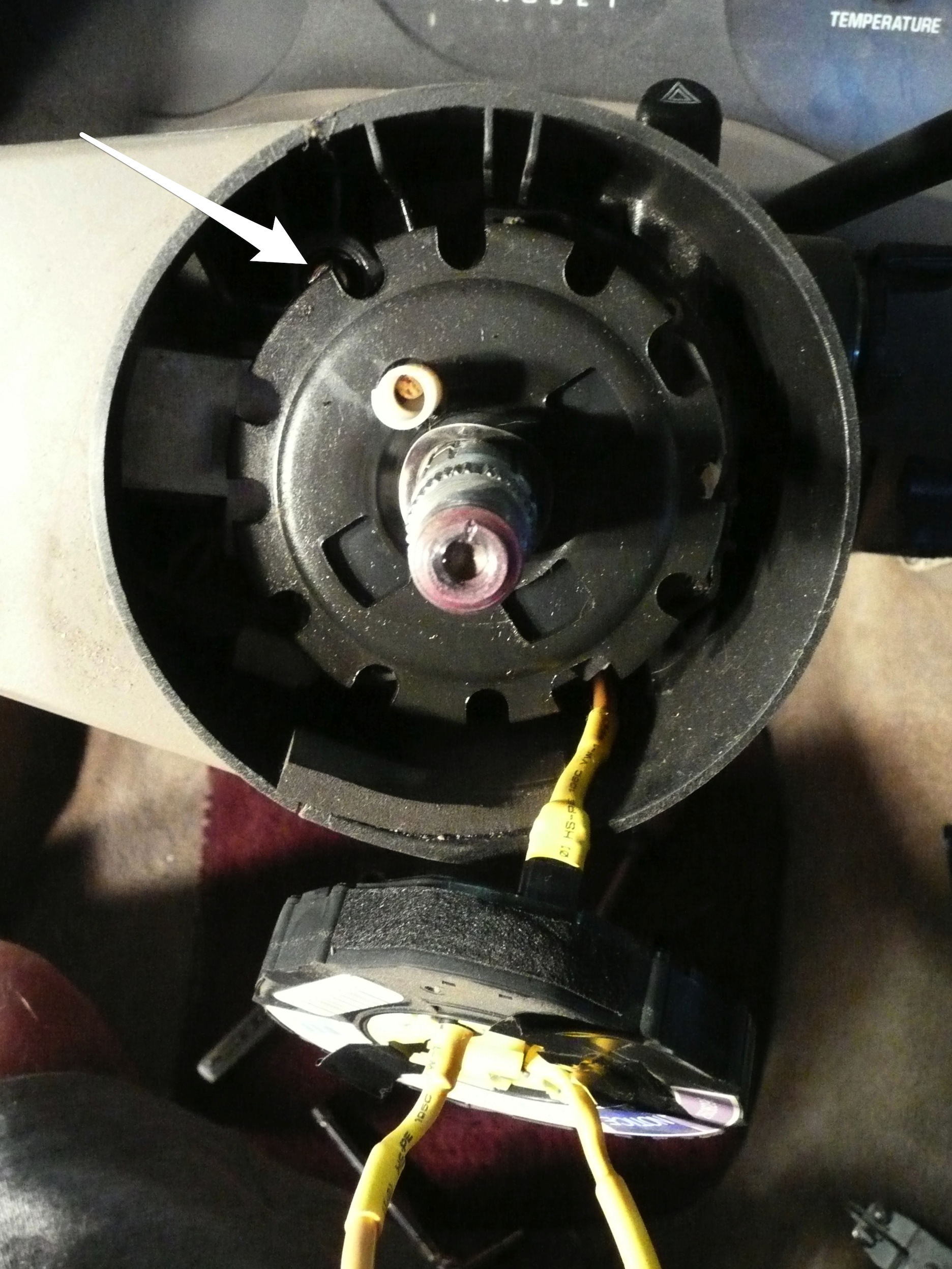

I subsequently noticed that in the pictures of the steering column from the guide I printed off of tss.likeabigdog.com were different. The spring loaded pin was nicely protruding into a slot on the edge of the lock plate. Subsequently, I went to a friends house and looked at his steering column (97 Lumina) and same spring loaded pin is in the slot. So I decided that mine should probably be anchored there too. When I did that everything went fine until I looked at the two alignment marks I had made on the coil. They are off by an 1/8". The guide says that you have to do a reset and the warning from my Chilton's is the same--Dont' let the inner ring move.
So, do I just put it back the way it was with the lip of the lock plate pushing down on the pin so that my marks align -or- do I leave it and try and do a reset on the coil? How do you do a reset on the coil?
