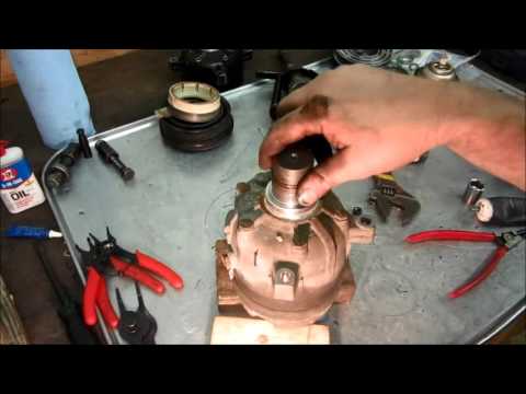

Hi folks. A while back, I made a still picture thread about re-sealing the V5 A/C compressor. This week, I did a full video teardown and rebuild. In this video, I go through all the steps to refurbish and re-seal the unit, including the shaft seal, body O-rings, and other areas.
This is especially important now that the parts stores are pushing Chinese knock-off compressors that absolutely do not last.
You are much better off with a good original unit. The seal kit was about $30, the pulley bearing about $20. For comparison, a new Delphi compressor sells for about $250, and a quality reman for about $200. So you are saving about $150 for around 2 hours work.
Another concern is the compressor configuration. They all require the same seal kit and shaft seal. However, there are multiple mounting "ear" configurations, multiple pressure switch port configurations, and multiple pulley configurations. For the older cars, it is getting hard to find the exact compressor you will need. Often the parts stores will sell a "universal" one that they claim will fit - but you have to modify the wiring harness, re-bend your A/C aluminum tubing and put stress on other parts to make it fit. If you take off the compressor and put back the same one, then you know it will fit without drama.
Due to feedback from my other videos, I chose to include the entire process, including parts cleaning. This lead to a long (1 hour) video. But, you can see every step of the process. The actual repairs didn't take much longer than the video takes to watch.
For the still-pictures thread, see here.
The video was filmed at a later date, with different compressor therefore the picture thread and the video may differ slightly.
Thanks for watching my video! If you liked it, please rate and comment. If you didn't like it or have constructive criticism, please leave a comment and help me improve my videos.
