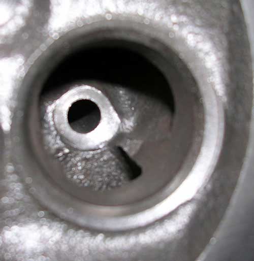

I don't know about the hot air passage. Is that the one that runs from #4? I simply ported so that the air would go by it and left it open

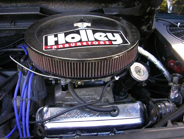

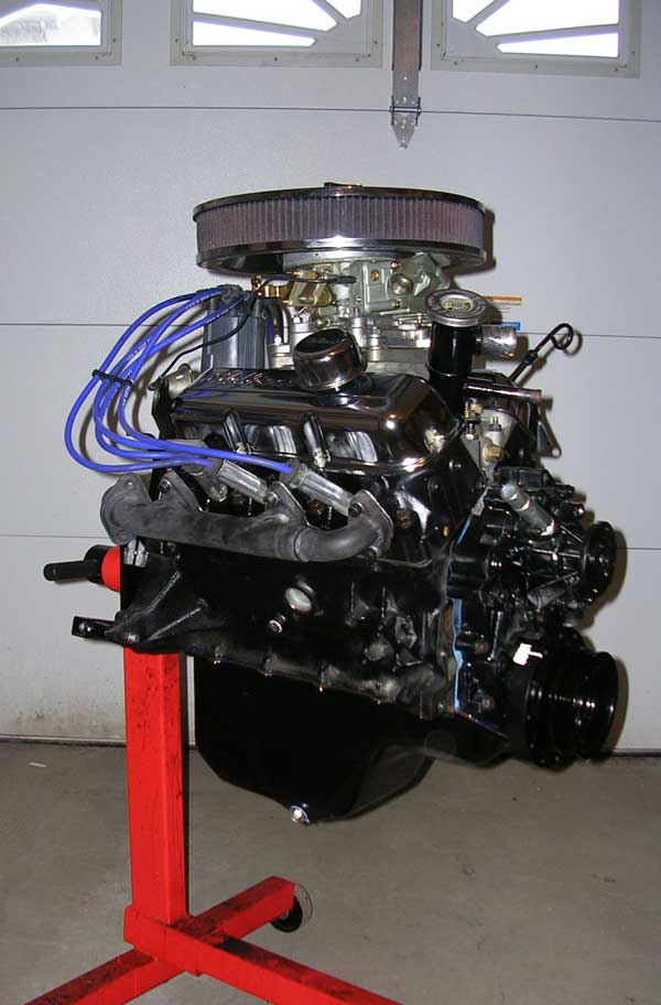

Anyway, I have the 390 cfm Holley on the Edelbrock intake. Tricky to meter due to the small engine, but I got it working well after alot of experimenting and research.

Yes ,the passage from #3 to #4, which causes a hot plenum floor inturn vaporizing any fuel puds and promoting better lower end in theory...but ........hurts top end stuff ,, just wondering if anyone had blocked it off without regrets.

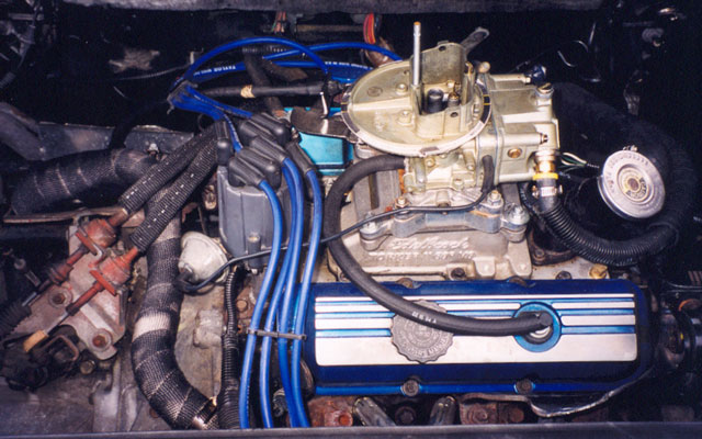

here is the 390 setup that works on the 2.8
This is my setup so far, however I do not have the secondary spring fine tuned yet.
#512 primary jets
#52 secondary jets
#31 shooter with orange cam center re-drilled for 1/2 shot
Light yellow secondary spring
8.5 power valve (my vacuum at idle is 16 and I need a richer power valve)
ArnArn Brown
Bruce, when I had the 2 barrel I was using #62 primary. #512 would have been too lean. I would set the power valve proportional to your idle vacuum. FYIOriginally posted by bruce farris View PostThanks Arn ;I'll try the #512 primary ,cam and power valve .I'm using a 500 2 barrel . I've had sucess using large throttle plates (over sized carbs), that's contrary to popular belief...but works quite well ..
