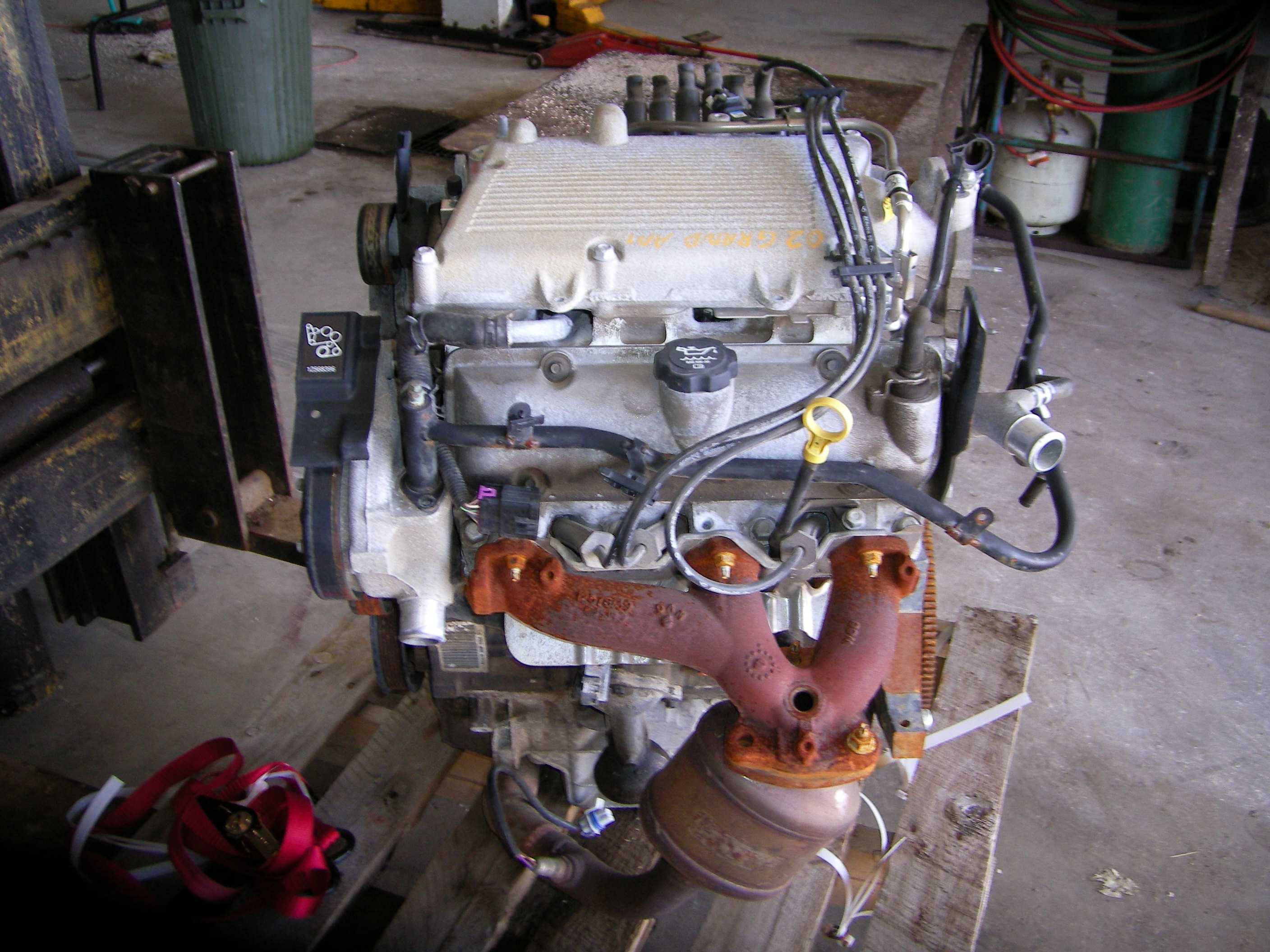

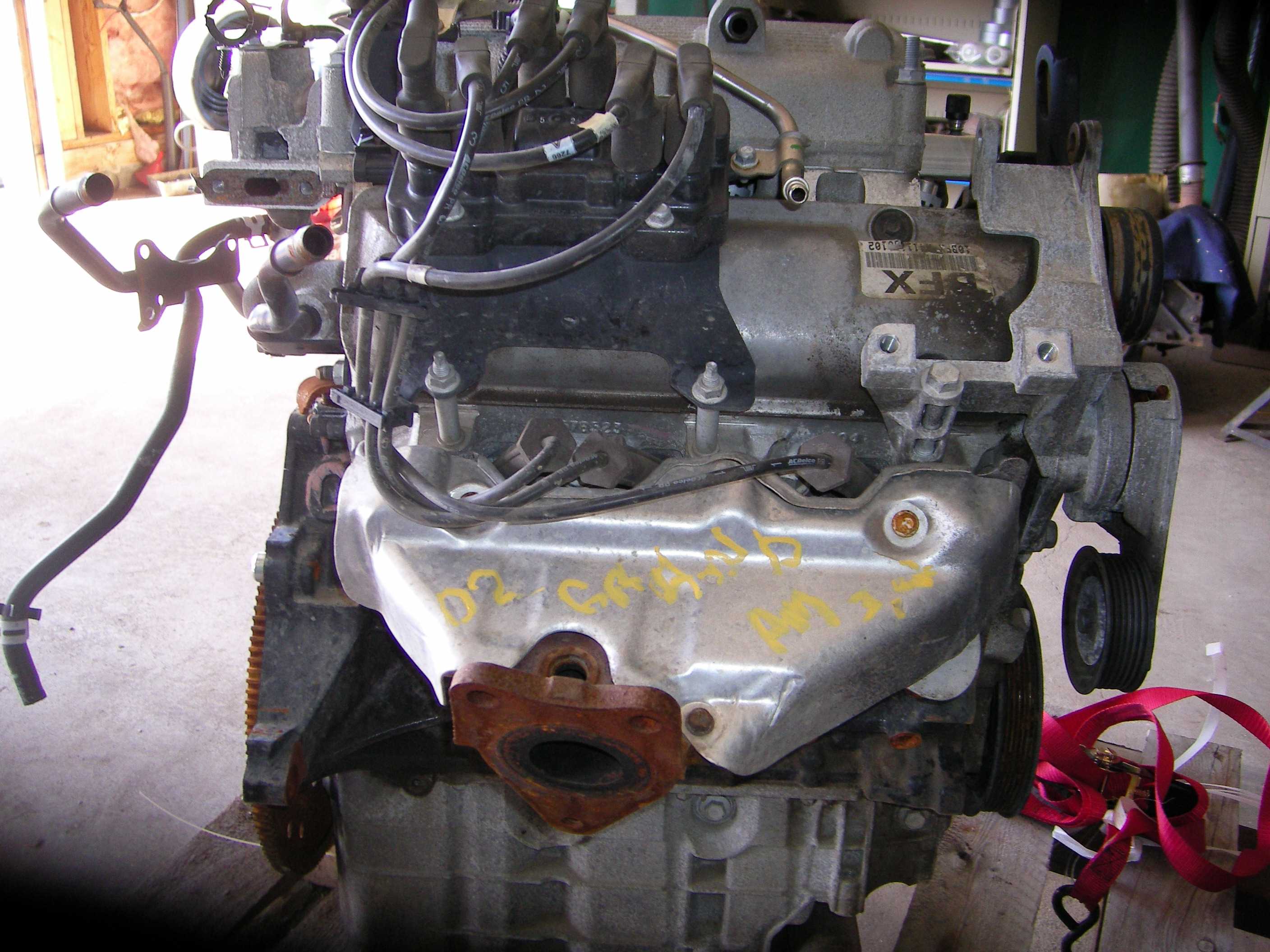

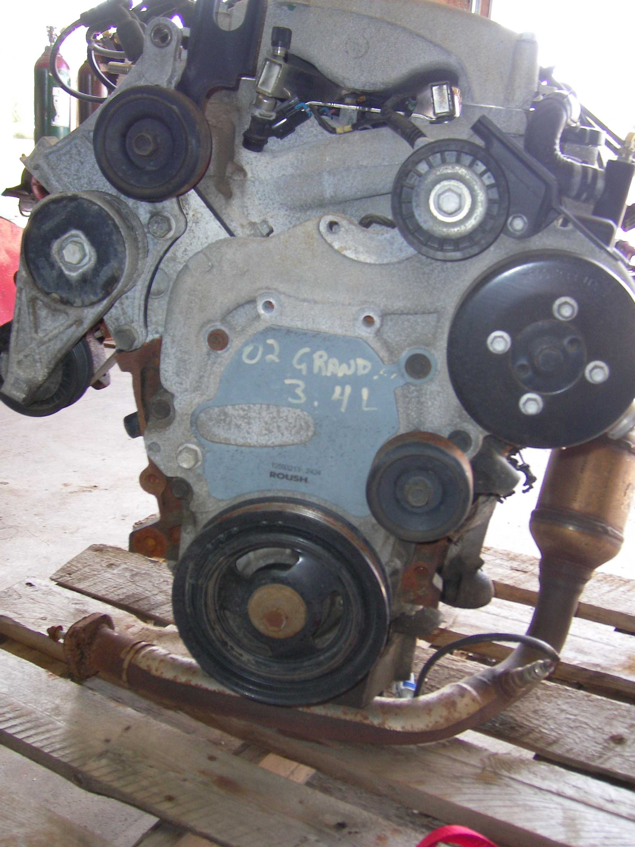

                      I went to the wreckers today and bought this core engine it was marked 02 3.4 grand am, but i dont believe that it is. Can you identify it from these pics? it was $100 so its a good deal even for the intake and heads but im sure its rebuildable, ill tear it down tonight.
                        It is a 3500!!! roller lifters, and rockers, it also has a Roush plate on the front, does this mean anything special?
                          That's definately a 3500 plenum. If it came out of a 2002 (for sure), then it's a 3400 with a 3500 plenum (or entire top end). Either way it's a good find!!!

                            Its definately a 3500. If you look in the 3rd pic, at the top of the block, there is a pink "C" cast into the block. The "C" means that it is a 3500 block. The exhaust manifolds are also a dead giveaway. So whoever works at the junkyard isn't the smartest, since the first 3500 came out in 04, and was never available in a Grand Am.
