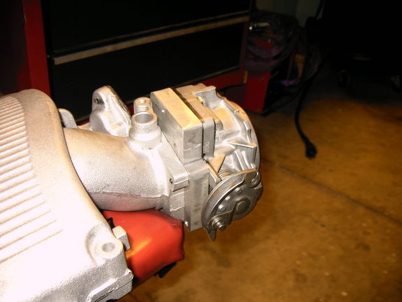

yup. it was really simple. made templates out of packing tape. then stuck them to a 5 by 5 piece of alum .25 thick. drilled the holes, and discovered that the adaptor can be bolted to the intake with the top two bolts, then you can drill out the manifolds bolt patern right through the tb and there is no problem. the two lower intake studs are what holds on my tb, and the one upper tb bolt is botled into the adaptor.
kinda hard to explain, but it works out nicely. i guess a pic would do justice. when i get a new linkage for the tb, ill post pics. my linkage has alot of play, so im going to get one from kinsler racing.
and i used a roll of gasket paper for a gasket3500, 1280 cam and PR, ls6 valve springs, port and polished heads, ported lim, ported uim, 4.3 70mm tb, ported trueleo headers and y pipe ALL FOR SALE (minus the car)

How did you cut the bore hole for the TB? I'm thinking of using the 65mm 3.5L TB possibly if I can find a cheap aluminum plate to mod again, and possibly rig my cruise to the linkage.. If my other plan doesn't work out.
Heh, gasket paper, I need to get some of that. I'm using the thin cardboard spacer that game in my FelPro gasket kit to cut gaskets out of LOL!sigpic

Thanks for the heads up on the TB Merlot. Just got one off ebay for $25
I will then write a CNC program to make an adapter in case one is needed later.
What TB is that?Originally posted by MidnightriderZ24 View Postim going to start producing these things again this summer. i had to stop making them when i moved to chicago for school.
That is the 4.3l 70mm TB. ^^^^ EDIT: It may be 75mm performance version but is a 4.3l TB for sure. Several TB's have been used on the 3500 plenum, some overbores. I think Mars_Man is using a bored mustang TB that's 70 or 75mm. The mustang bolts up without an adapter but has no IAC.
