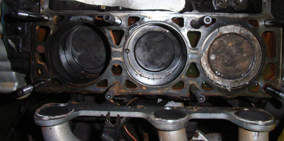

    Does anybody know/recommend any engine builders with experience with the 60deg engine family? After almost 10 years, my stock 3.4L camaro short block finally failed (Probably had nothing to do with the fact that I was trying to step up the tune...) Engine was pulling hard, almost 12psi, then pop. I am running a B&M Supercharger with about 6 PSI on the street and 9psi at the track, ran the 12 PSI pulley setup exactly ONCE, oops. See photo look at piston #6 on the top left of the piston.
    Anyway, I know that just about any piston company CAN make me forged pistons, and any good engine shop CAN build the engine, I am just looking for somebody that has some experience with this engine. Around here if its not a V8 or a Honda they just kinda look at ya strange....

            some of the guys on the Jbody forum were discussing a group buy on forged pistons for the 3400 which is the same bore and uses the same rods as your 3.4. You'd have to get yours with a smaller dish volume since your heads have a much larger combustion chamber than the 3400 does though..

              Thanks SuperDave, I will look into it, I actually want to drop the static compression ratio so the extra dish volume might work out.... Andy
