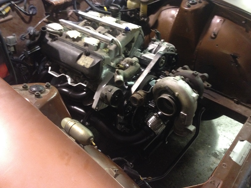

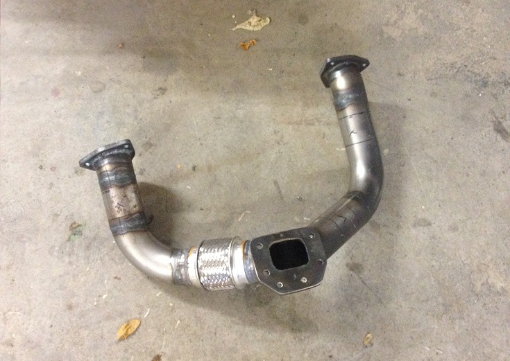

    In relation to earlier discussion in this thread about equal length left and right headers, into equal length Y-pipe into turbo, that's exactly what I have in my 240Z.
    [ATTACH=CONFIG]8524[/ATTACH]
    [ATTACH=CONFIG]8525[/ATTACH]
    [ATTACH=CONFIG]8526[/ATTACH]
    [ATTACH=CONFIG]8527[/ATTACH]
    [ATTACH=CONFIG]8528[/ATTACH]
    I gotta say it sounds like a pissed off 2 stroke when it gets up on full song.
    I don't have any videos yet, other than an idle video in the winter when I had some injectors that didn't work out as well as I would have liked.
    I'm actually looking for a way to get the raspiness out of it. I have some ideas, just not sure what I'm going to try first.
    Not sure how much room you have to work with under the car but a good way to reduce the raspiness is to attenuate the frequency with a 1/4 wave resonator, depending on what range you want to silence.
