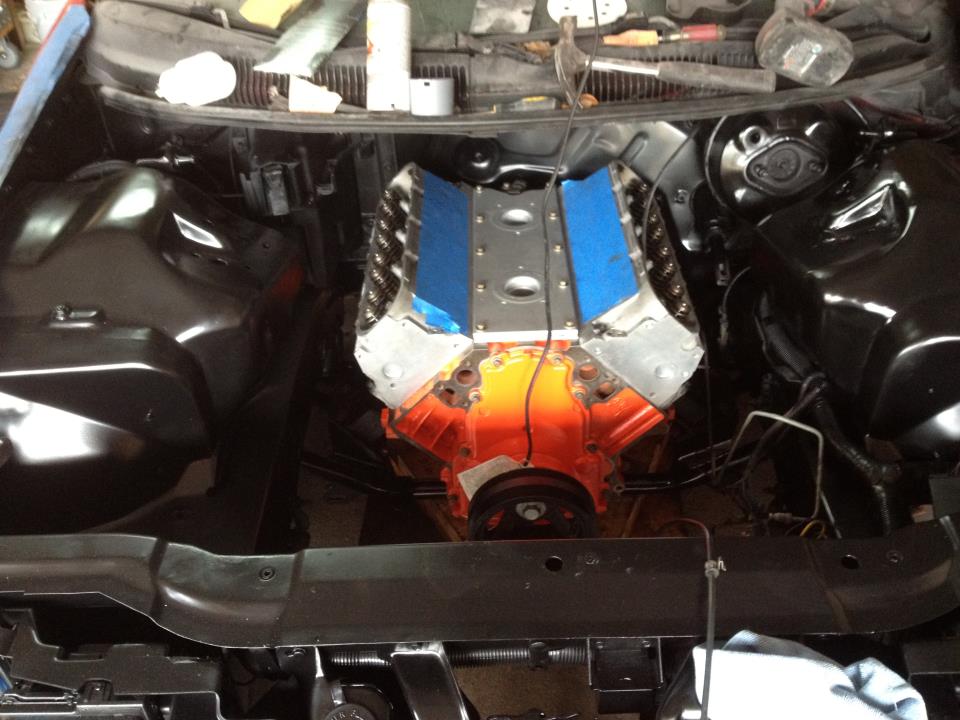

Hahaha, I guess I should up date this a little bit... Found the problem. the cam was worn out, so no lift, no power, no rpm. the solution?
5.3. Sorry folks, I've betrayed the 60* v6. If someone want the 3.4 motor and trans let me know. Its for sale. 500 bucks if someone wants to pick it up. (in Austin TX), trans was rebuilt about 15,000 miles ago and shifted fine.1995 3.4 Camaro: headers, cold air intake, catback, ignition upgrades, suspension mods...
Looks good. Flat cams were not un common on the 3.4L. Good thing you figured it out. If you did not live so far away I would take your whole 3.4L package you got there. But I bet shipping costs what you are asking.1993 EXT. CAB, 3.4L V6 TBI, 5spd manual. Sonoma
