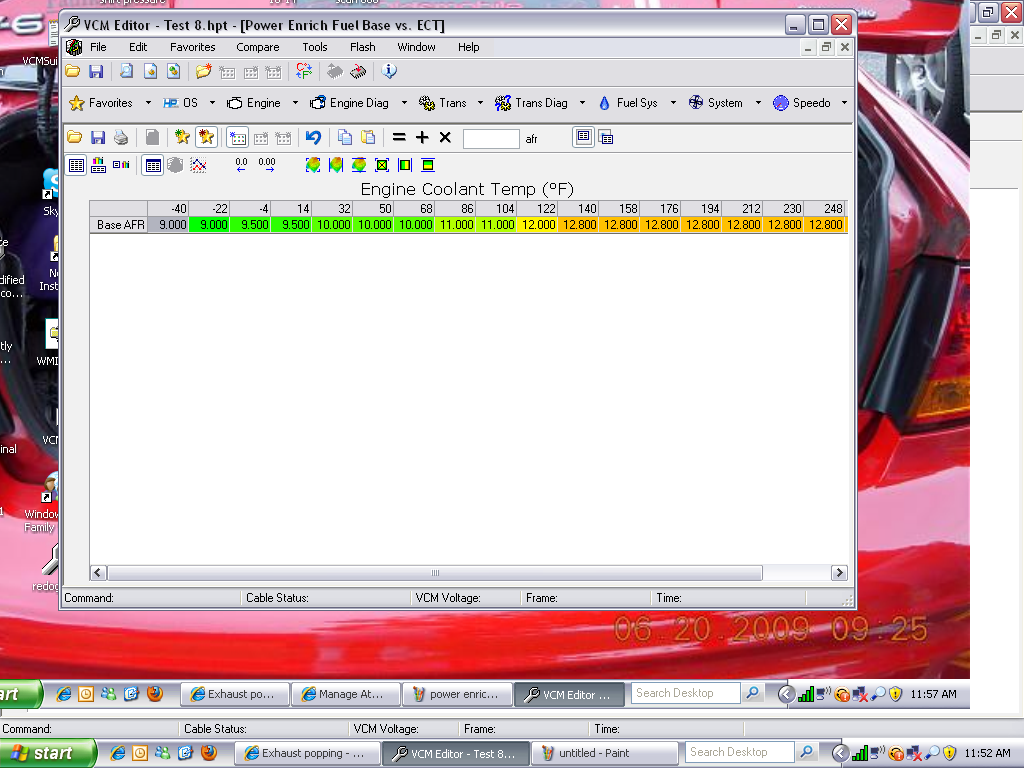

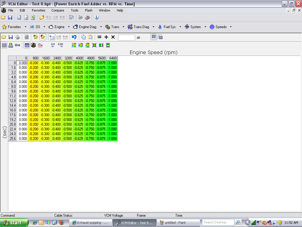

I had a nasty exhaust leak at the headers so I repaired that with the gaskets from WOT-Tech and that's good now. My exhaust used to pop at the header (mainly 2, 4, and 6) but now it's still popping under heavy load, but the popping either under the car or out of the tail pipes.
Ben was helping me a lot with tuning and said in order to go futher, I would need a WB A/F gauge. I was waiting on Autometer's 4970 gauge for a year, but they are not making in now
so I got a regular gauge with the ditigal readout.
Drops as low as 10.2 when I get on it and when I stop after that, I've seen it go as high as 17.4. I do have HP tuners, but I'm really a tuning novice.
Any help, I would be very greatful
