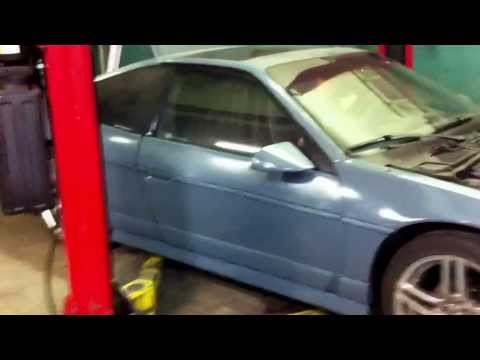

Got the top end back together
... just kidding
New valve reliefs visible
Started it up and it runs nice and smooth. However overheating issue remains. It's like the coolant isn't being pumped through the engine at all. Heater core lines will heat up fairly quickly but the hoses going to the rad are still ice cold when the engine is at operating temp. Replaced the T-stat with no change.
My first thought is a bad water pump but I replaced it only 20,000 kms ago or so. Or a really persistent air lock?? I'm gonna try flushing it a little with a garden hose attachment to see if that makes a difference; if not is there anything specifically I should check before replacing the water pump? Pulley still spins fine.
