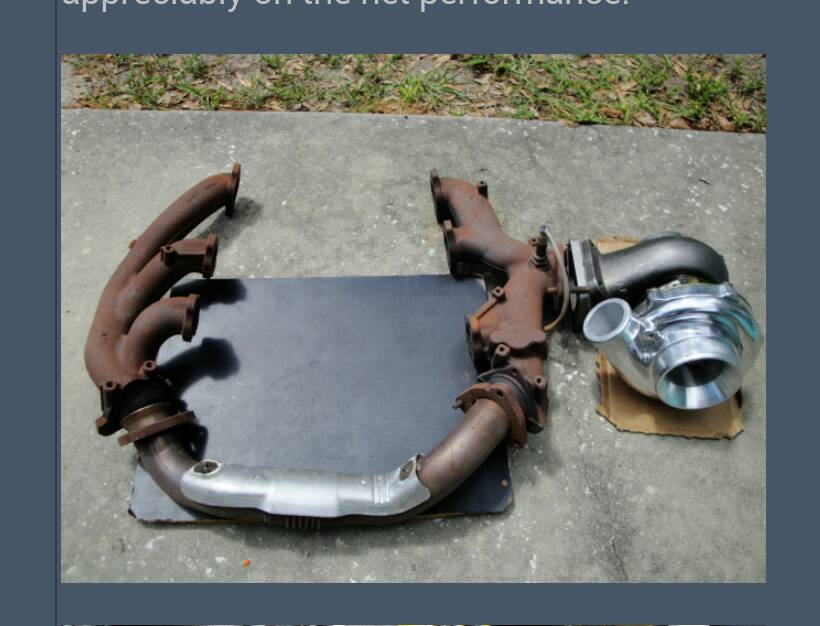

Like I said in the PM, that's a terrible design. You might as well just use a pair of 3500 front manifolds and a few 2" U bends to feed the turbo. They'll way out-flow that setup and will last.

I think it was one like that, it only showed up on tapatalk though. They save space for sure but man do they flow terrible. I'd hate to see you go through all that trouble and then be disappointed.

It doesn't get much easier than that, just a few 2" U bends to weld together and you're done. Remember to add a flex pipe between the banks though.
I'm glad to see someone talking about flow when it comes to a turbo header... I feel that way to many people ignore that factor when designing turbo headers and think the log method is just fine... Flow on a turbo setup is just as important as on a N/A setup... It determines how log you'll be sitting there waiting for it to spool up

Log manifolds work, and don't flow as bad as you would think in a turbo situation. You have to remember pressure is building in the manifold - usually 1.5-2x the pressure of the intake side of the system ie if you are running 10psi gauge pressure/boost, then your exhaust side is seeing 15-20psi.
