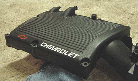

I got it painted. It will look even better when on the engine. Tell me what you think:
More pictures and a description of what was done to it can be found here:
http://www.v6z24.com/jbodyforum/viewtopic.php?t=83801

That looks pretty sweet IMO.-Brad-
lookin real good couldn't even pm me the link on v6Originally posted by IsaacHayesI got it painted. It will look even better when on the engine. Tell me what you think:

Heh I was going to but figured you'd see it at either place since you check in probably as much as I do.sigpic
New 2010 project (click image)
Nice man! I may end up painting mine black too, since the lower manifold, and valve covers are also painted black.Brian
