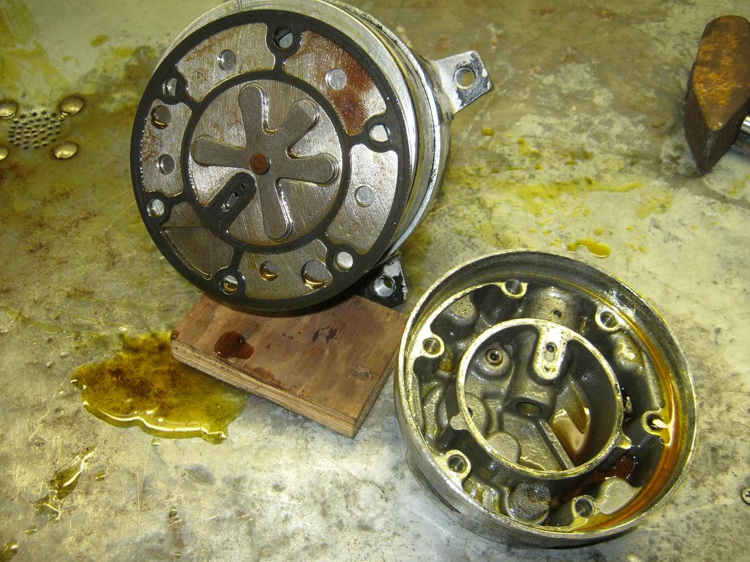

    Use a soft hammer (or block of wood) and drive off the rear housing.

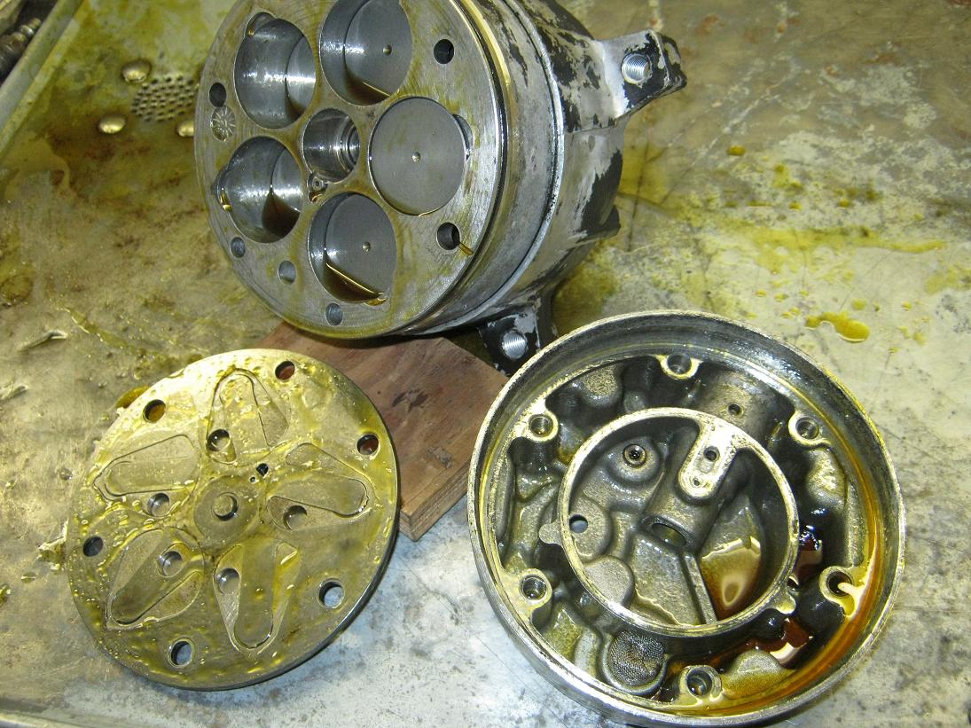

    Remove the valve plate and inlet reeds.

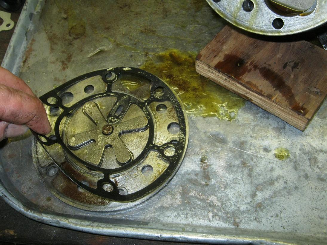

    Take the old gasket off the valve plate.

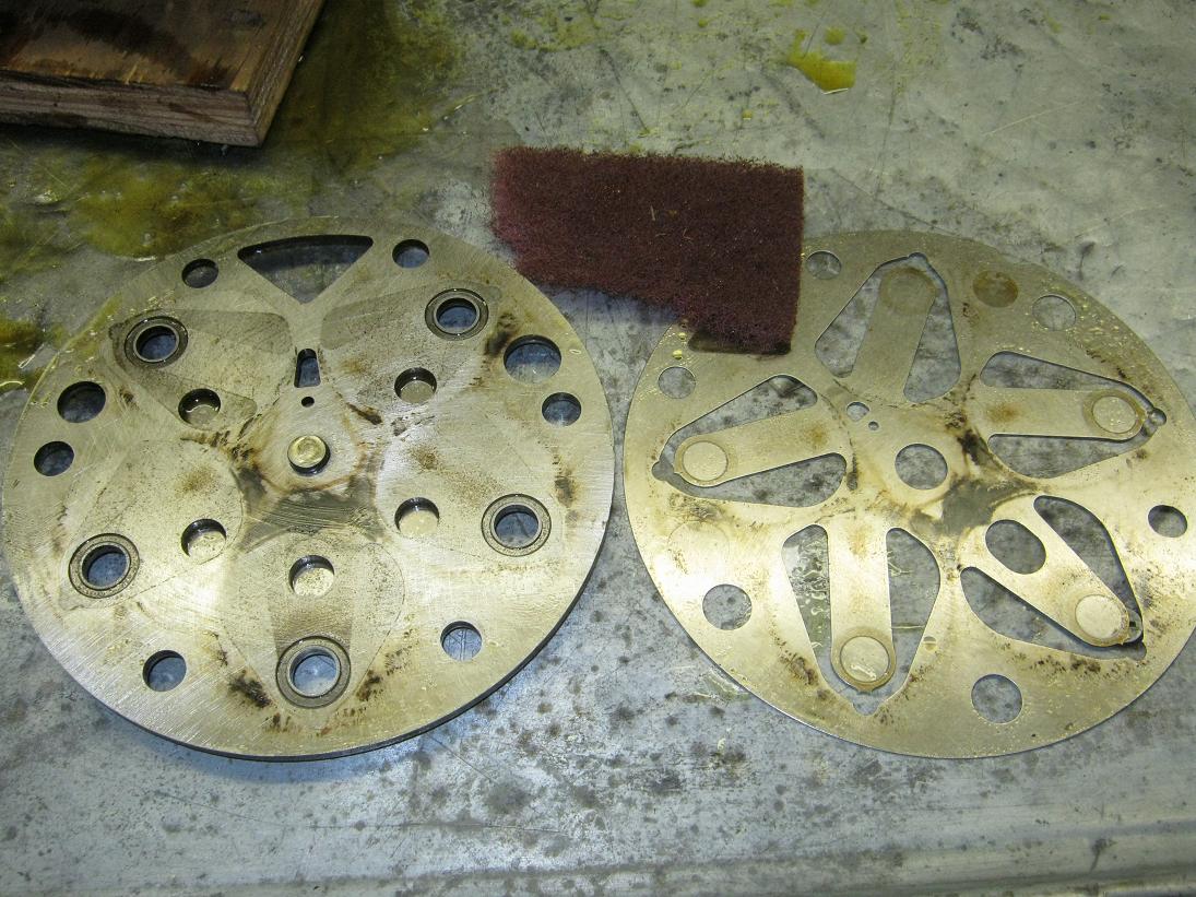

    Clean the valve plate and reed by hand with red scotch-brite and brake cleaner.

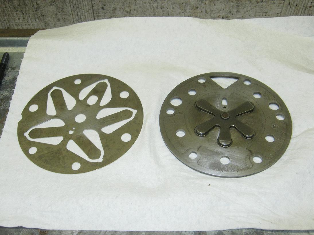

    Place them in a clean place. Cleanliness is CRITICAL to this success.
