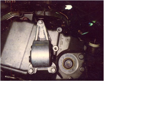

    Front Mount:
    1. Production Mount
    2. Adapter Plate

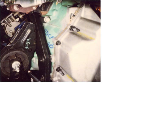

    Side Mount:
    1. Production N-Body Side Mount, trimmed and welded to fit the 4T65E HD

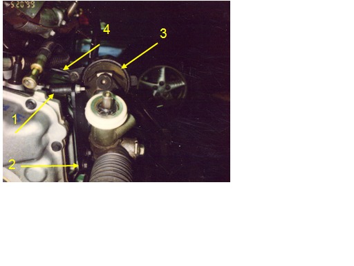

    Rear Mount:
    1. Stud with spacer in existing 4T65 HD mounting hole.
    2. Two 10mm X 1.5mm bolts in existing 4T65 HD mounting holes.
    3. Production rubber mount from 98 GA manual transmission application.
    4. Custom pencil brace to existing transmission mounting hole.

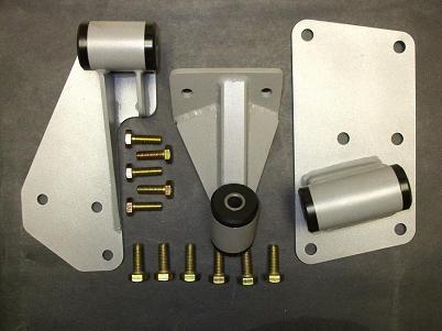

    Milzy Motorsports 4T65E HD Conversion Mounts:
    Milzy Motorsports offers all 3 mounts for a price of $450.00, by far the easiest option however it is also the most costly option. It is important to note that the rear mount (pictured far left) is specific to the 4T65E HD transmission and will not work on a 4T65E transmission case.
