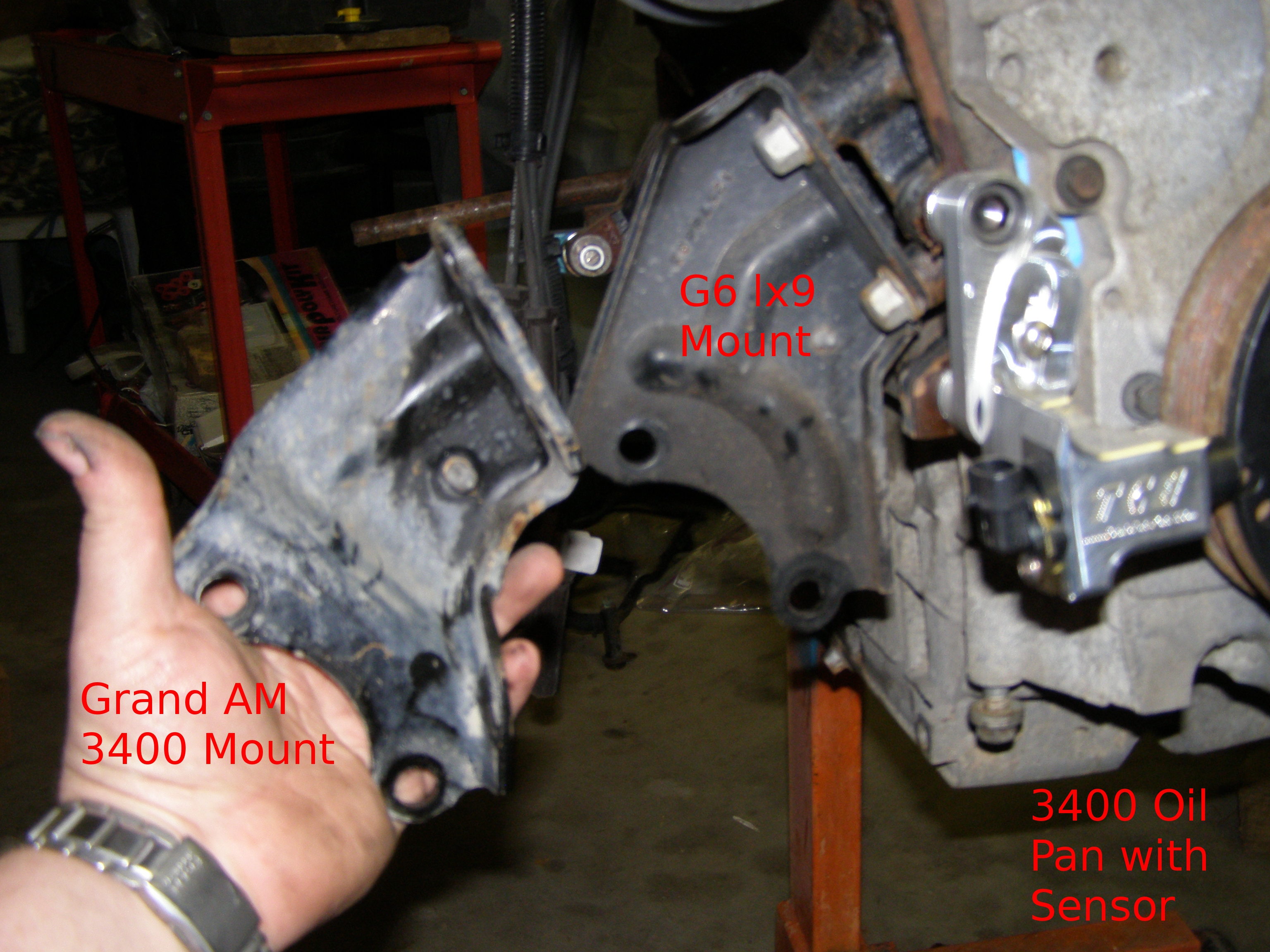

                    Theres really only a few things that require modifications.
                    1) Timing ring - basically your only option is the TCE setup

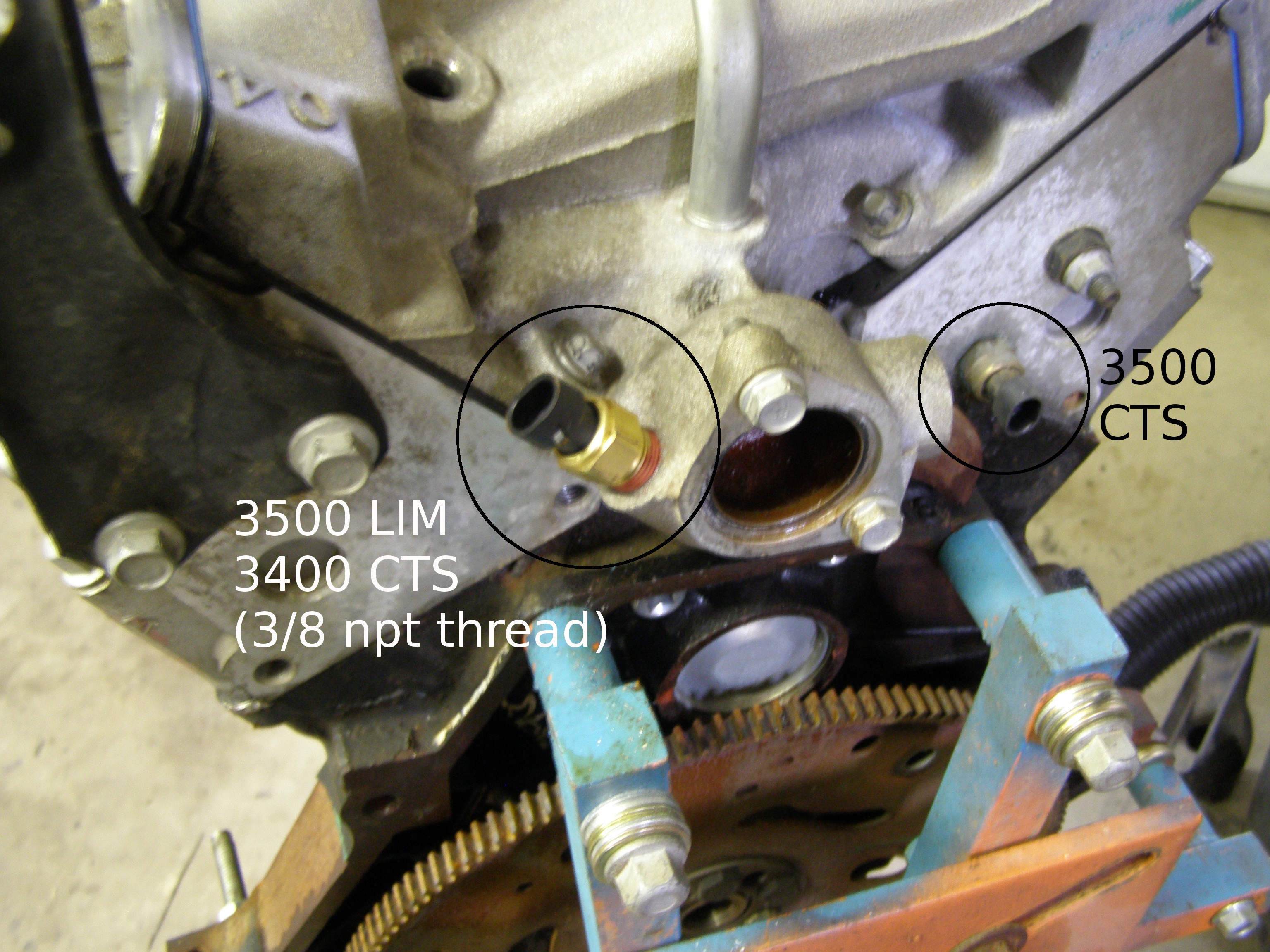

                    2) CTS - I tapped my 3500 lim for a 3400 sensor

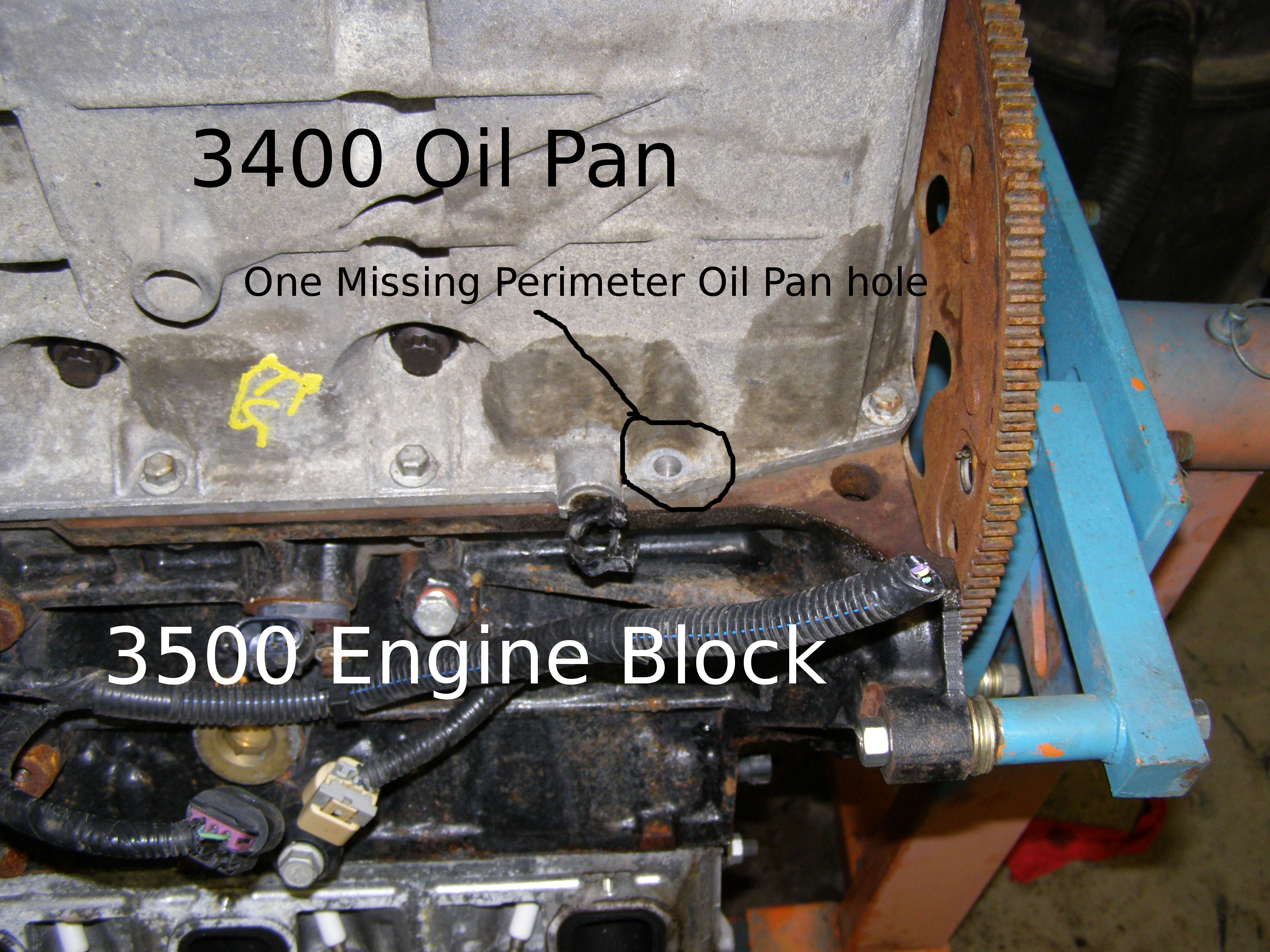

                    3) Oil Pan - As you said. not necessary to swap if you dont want the sensor, looking back I probably would not do it again, but its too late
                    4) Engine mounts - You have to use the rear upper mount from a G6 and the lower one from your grand am works fine with no drilling

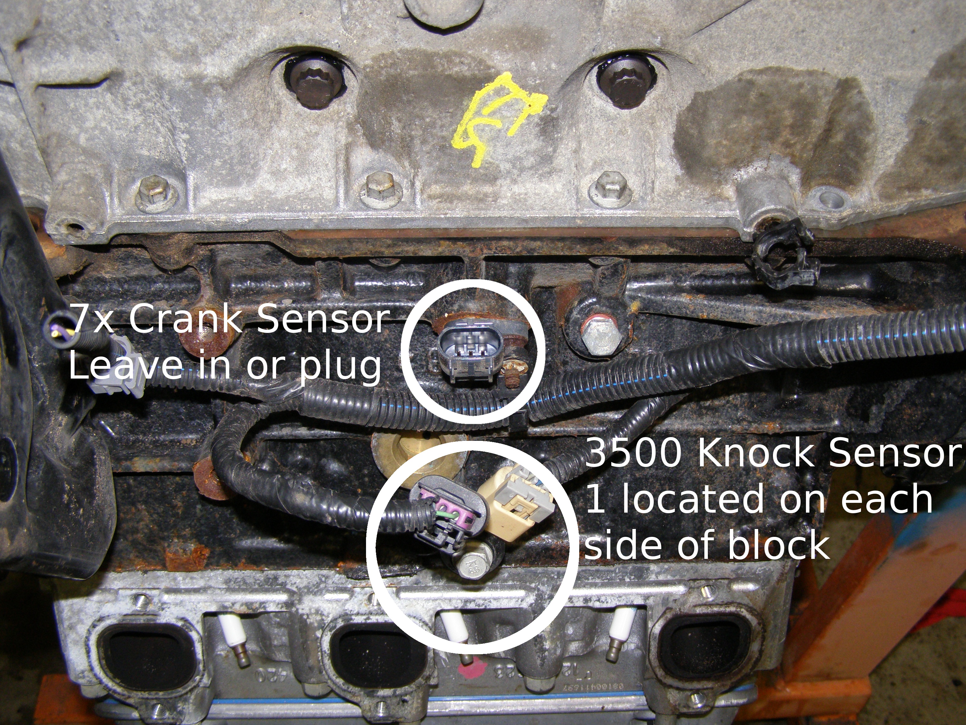

                    5) Knock sensors - The 3500 has two knock sensors that just need to be removed. a 3400 knock sensor threads right in. It goes right above and to the right of the oil filter
                    6) Oil Pressure sensor - My memory is a bit fuzzy, I'm not sure if I had to change this maybe someone else can chime in. I replaced all new sensors on my engine before I put it in.

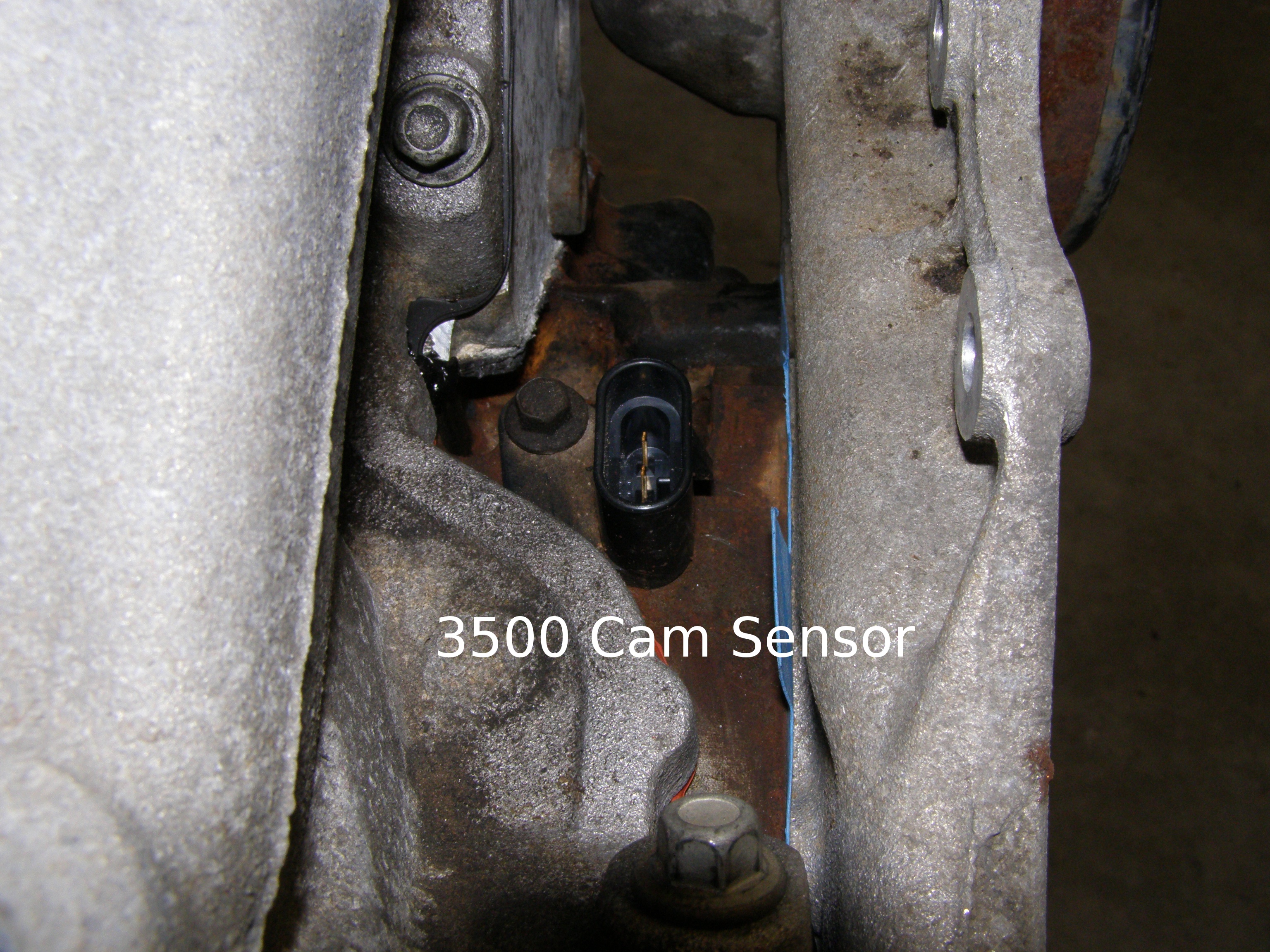

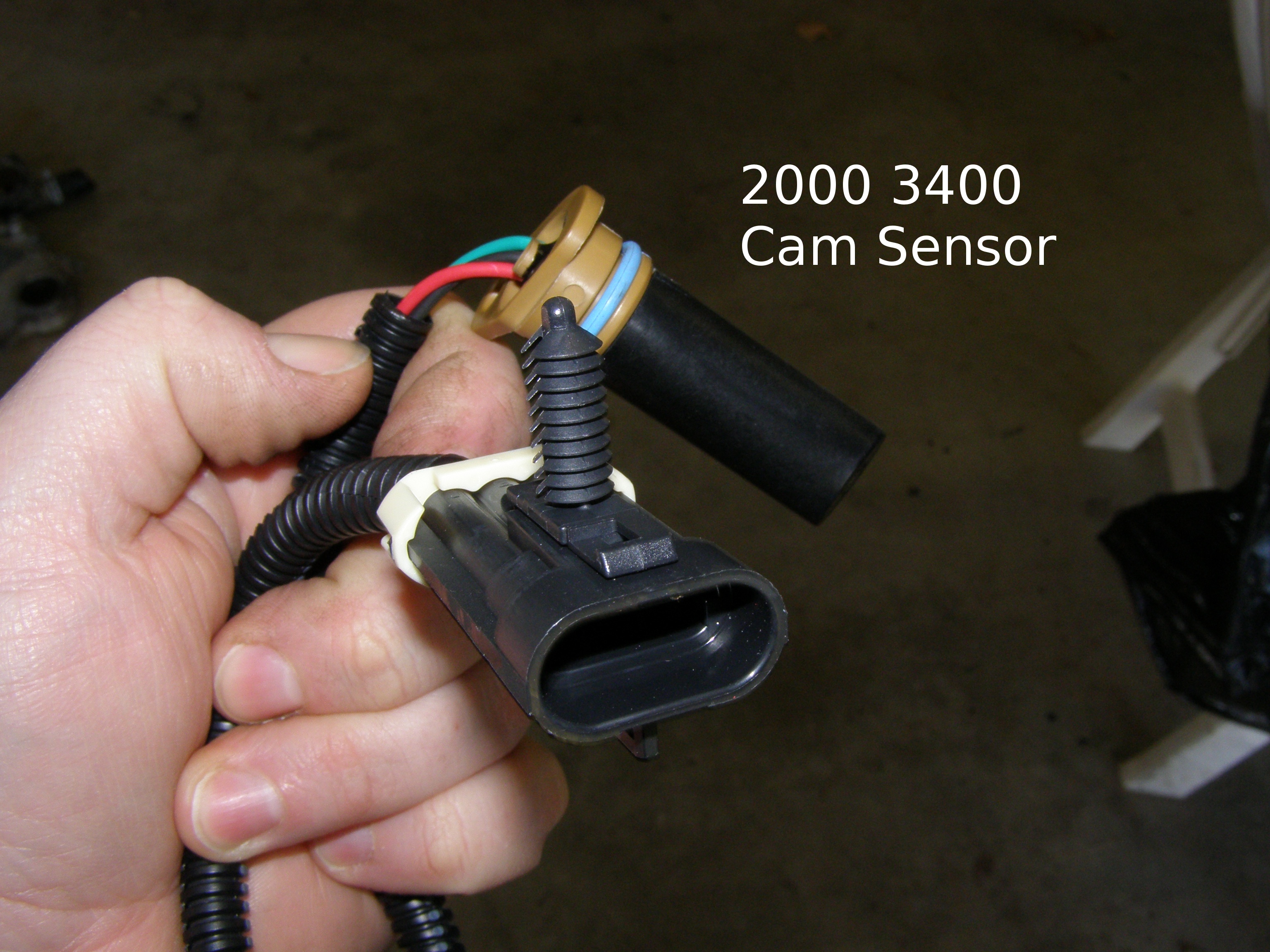

                    7) Cam Sensor - if you have a 2000 GA your cam sensor needs to be on a pigtail. the 3500 sensor just pulls right out. take out the retaining bolt and pull it out. Plug the new 3400 one in with the pigtail and bolt it down.
                    Fuel rail - you have to use the 3400 fuel rail with compatible multec 2 injectors

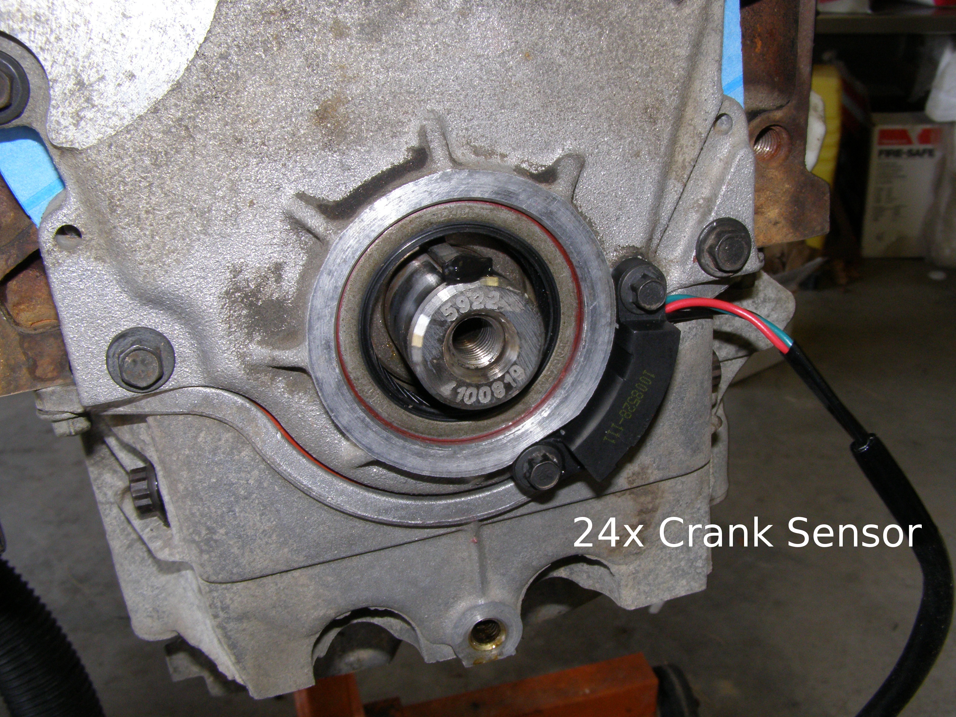

                    9) Timing cover - the timing covers are nearly identical but your accessory arrangement is different. you also will have to install a 24x crank sensor on your timing cover behind the crank pulley. You MAY also have to do a CASE relearn with this. I lucked out this time. It runs perfect, but I'm gonna do one eventually when I have the tools just in case.
                    10) Crank pulley - You have to use a 3400 crank pulley
                    11) A/C Compressor - Just like the engine mounts the 3500 bosses sit at a slightly different angle. I had to space out the single bottom bolt with about 3/8 worth of washers
                    12) Alternator bracket - use the bracket from your GA
                    13)
                    If theres one thing I can advise tho. Definately get the felpro lower intake manifold gasket set. And use a good accurate torque wrench to bolt it all down. HUGE improvement over oem
                    I've attatched some pictures.
                    Good luck man!
                      13)
                      Good luck man!
                      Ok, I just need to clear a few things up:
                      In regards to the cam sensor. Are you saying I need to GET a pigtail or just use my cam sensor from the 3400 that has a pigtail?
                      Since there are different accessories, do I need to swap timing covers then? And will I have to purchase the 24x crank sensor or does one of the engines already have this and all I need to do is swap them? Also, does the case relearn have something to do with the PCM?
                      I really appreciate the help, I was just a little unclear by what you meant in regards to those things. Thanks for the pictures! Pics def help me alot.
                      Also, I don't have the 3500 yet, its on its way. I am not sure if it will have the G6 bracket on it or not. If not, can the slight angle difference be modified slightly to make to make it work?

                        Swap the cam sensor from your 3400 or buy a new one meant for a GA.
                        Its worth it to swap the timing cover IMHO. The 3500 does not have a 24x sensor on the timing cover.
                        You can modify the bracket from the GA to fit the 3500 block if your good at welding or know somebody who is.

                            the holes are allready there to swap the 24x sensor. so swapping the cover is kinda useless.
                              Exactly. The hole are already there. I never said to swap timing covers, just said the accessory arrangement was different haha. But I did swap timing covers, but only because mine was broke at the water pump.
