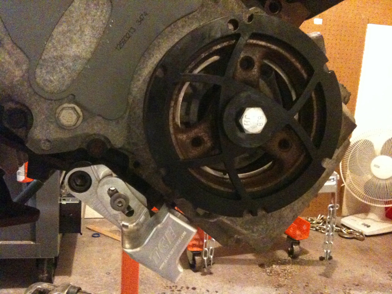

    Does the below pic look correct?
    Two bolts secure the bracket for the CPS mount to the block. 4 washers came with the trigger that I assumed were to be used between the block and the CPS mount to space it correctly with the trigger wheel. At first I used 2 washers for each bolt but it looked with the CPS would be be too far out to align correctly with the trigger wheel so I went to 1 washer for each bolt and it looks better. So the question here is 1 washer under each bolt ok or are 2 required. I don't have an actual CPS to mount yet, I will likely reuse the one from the old motor.
    I did not use thread locker anywhere, should I have? This includes the 2 large bolts mounting the CPS bracket to the block as well as the timing adjustment bolt. I torqued the 2 large bolts down pretty good and the small bolt for the timing adjustment snug within reason (considering its threaded into aluminum). The smaller one is the one I question needing threadlocker.
    (yes, the motor is rotated about 45* on the stand)
      [ATTACH=CONFIG]5286[/ATTACH]
      That picture is correct. I only used 1 washer as well, 2 washers pushed the cps center a little too far out. I used blue threadlocker on the 2 block bolts. Didn't put any on the adjustment bolt thinking I'd possibly need to adjust it.
        Yeah, I would use blue as well. I've heard of a person or two that didn't and had those bolts start backing out on them.

          Thanks guys. I'll redo with blue locktite. I may use it on the adjustment bolt as well, I'm setting it at 0 degrees with not intention to change since timing adjustments can be changed via the computer.
