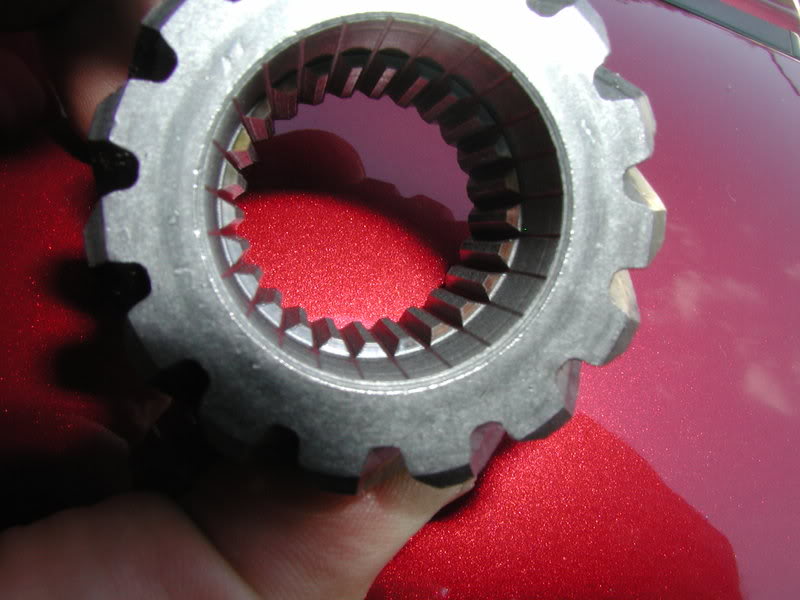

                  Are you using an OBX LSD? If so did you chamfer the edges of the axle gears? If not then you may end up having to destroy the axle clips to get them out.

                      If he didn't rebuild/modify the diff before install, it will likely be VERY difficult to remove the axles.

                            After the axles are out I recommend removing the diff and modifying it as necessary so that this doesn't happen again. There are quite a few write ups on how to do it. Also it's a good idea to replace the pre-load washers. The ones the come with the OBX diff are weak and often incorrectly assembled leading to incorrect LSD behaviour.
                            Also in my case the bolts that hold the LSD together weren't even close to torqued down when I received the diff. Torquing them down properly with blue locktite is recommended.

                                I've done the rebuild to an F23 OBX diff. It's pretty much exactly like the write-ups out there. It sucks that for you you can't open up the trans until at least one axle is out.
