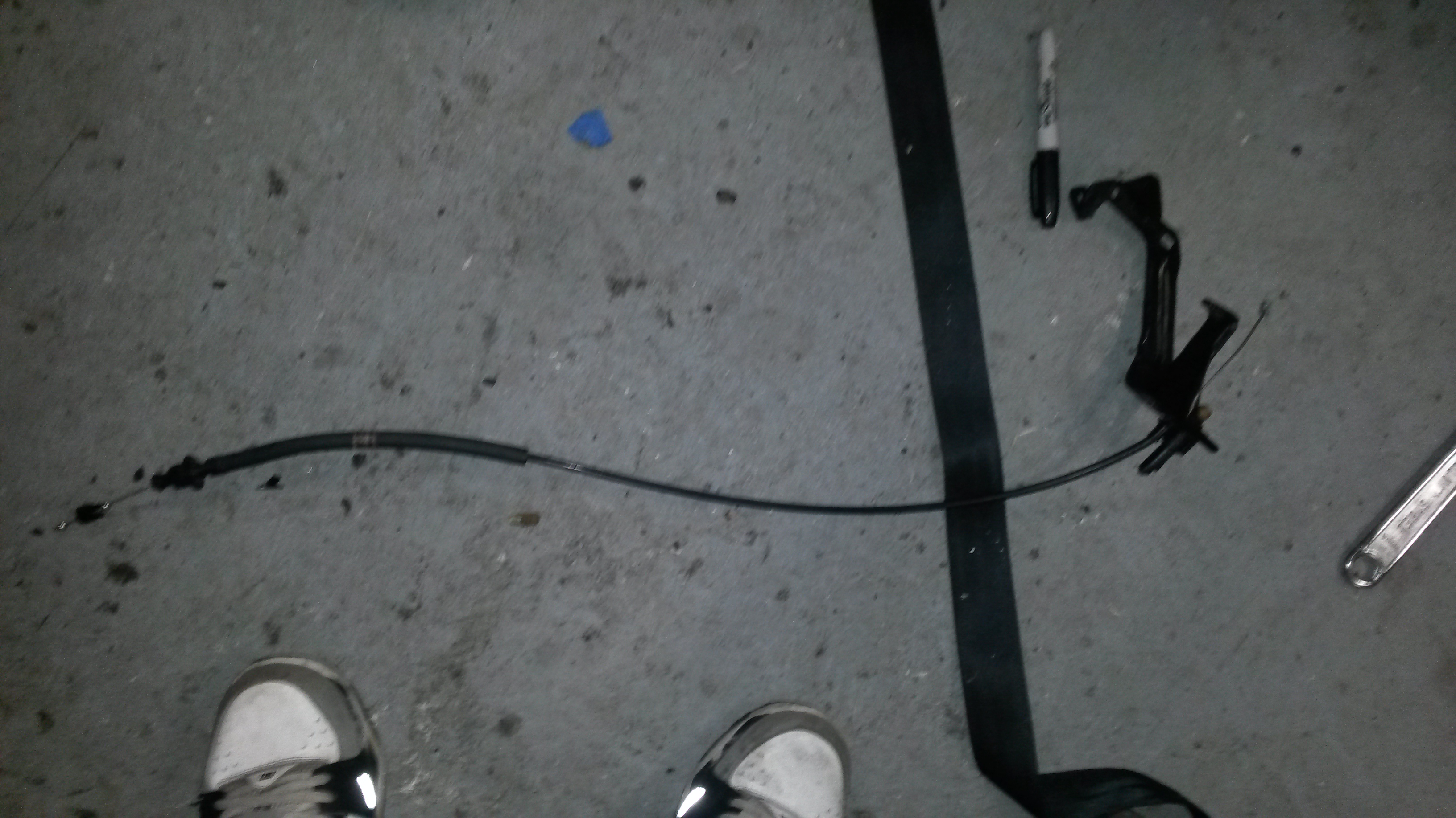

          i do want to ask anyone if they know what throttle cables work. i have one from a 95 cavalier 3100. the hookup is the same but im not sure about the lengh, worried i just may have wasted money. any info on that would be awesome

              Cavaliers never got a 3100, a '95 Cavalier would either be a 2.2L or the 2.3 HO.

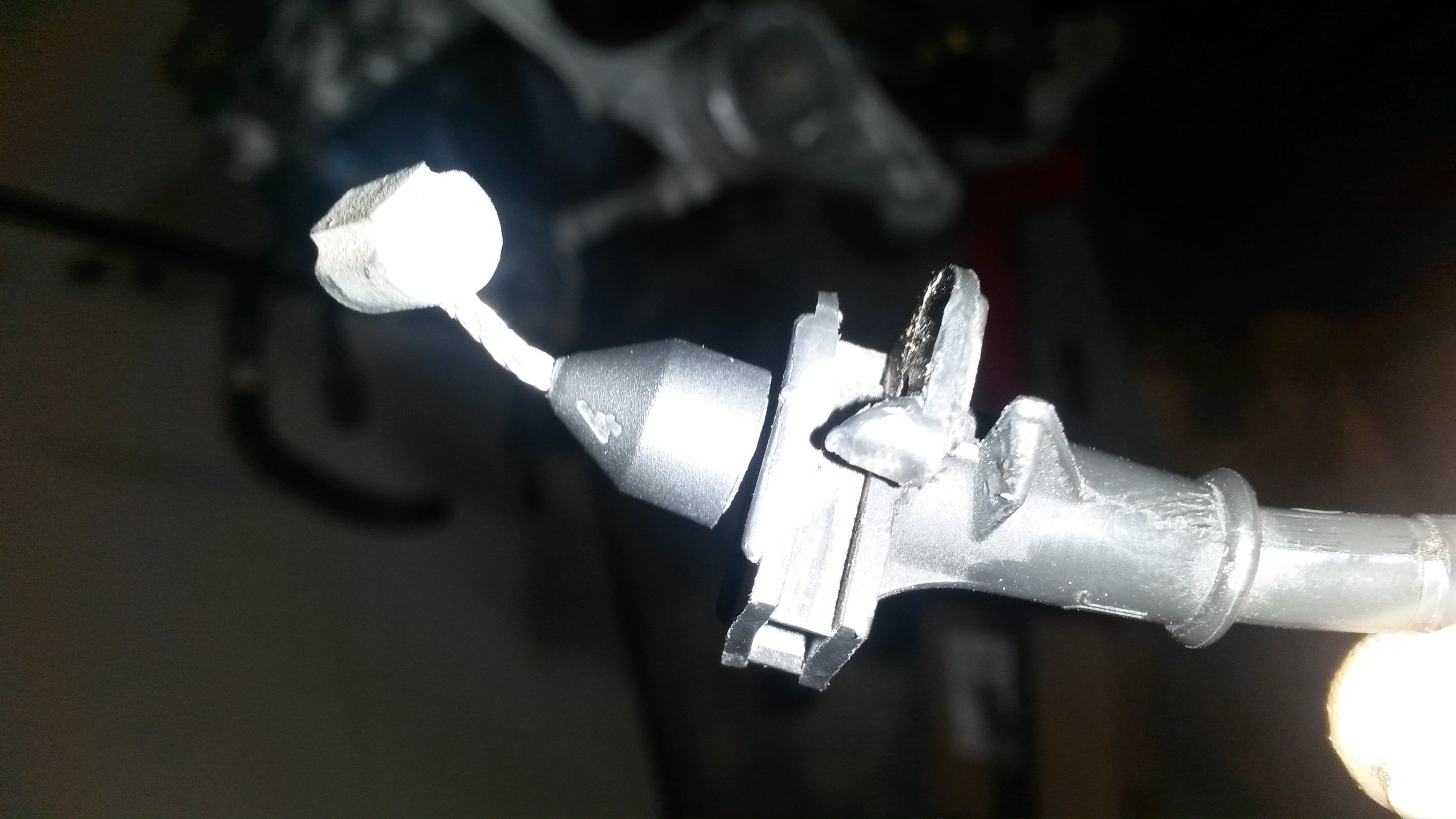

              The cable may still work though, you'd have to post a pic of the end.
              3100 Corsica/Beretta cables are a perfect fit if you can find one.

                GM DOP: 04/95

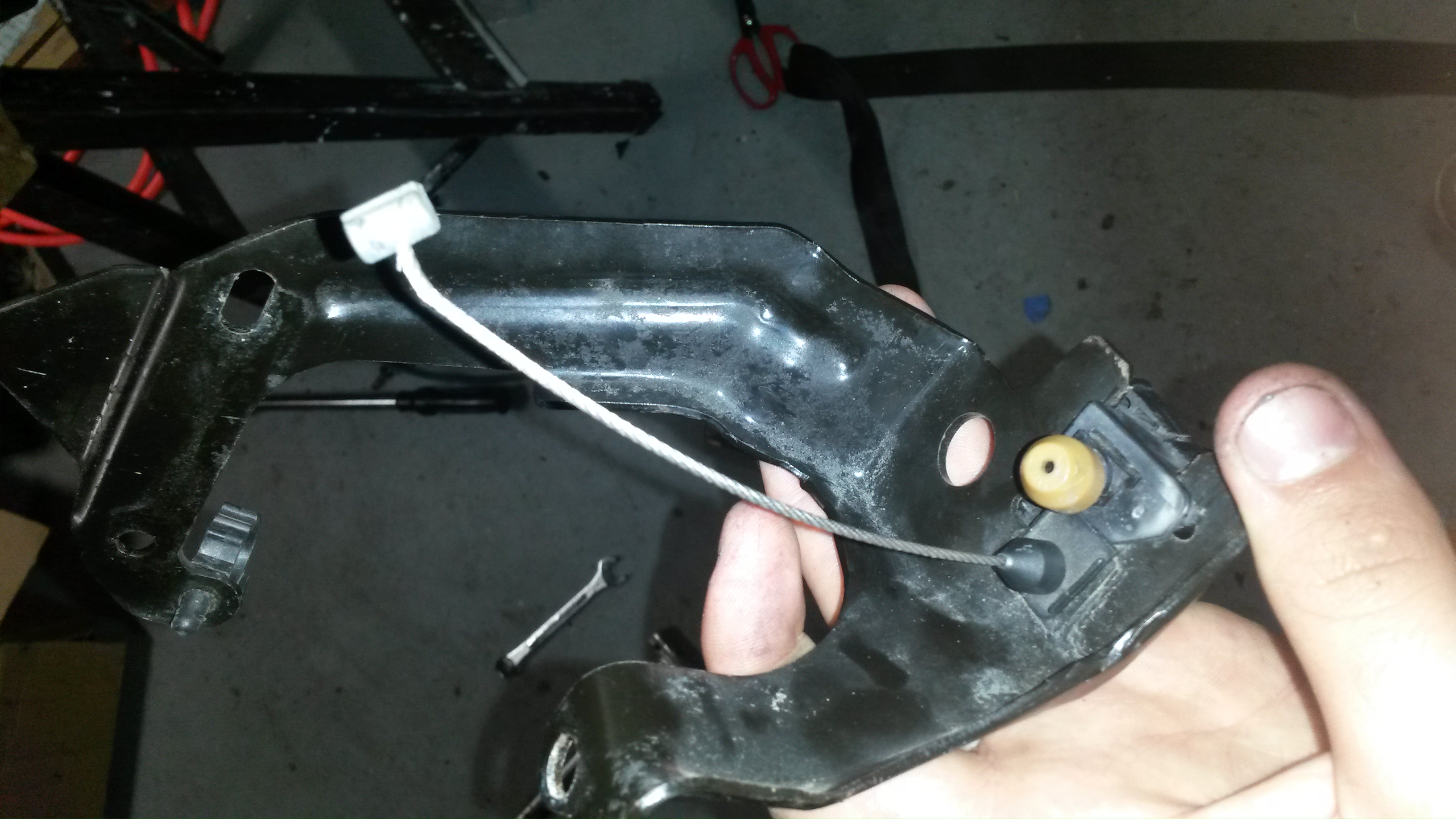

                it had a 3100 but it did have the motor mounts like the GAGT right on the rad support. looked like it belonged in there lol. i think the end is different it looks like one from a bike brake cable. and superdave i did mean to tell you i plan on deleting the EGR assembly, seems like a waste of time to adapt it its already a QQ in newjersey next year! lol i also bought a spec stage 2+ clutch ive read good things but id like to hear it from the master. and i cheaped out and bought an oem replacement flywheel. it should be alright tho. my thing is is i joined the marines and im leaving for bootcamp in october. the clutch will be here at the end of the month and i still need to buy the chip and make an egr delete. i want to get this swap done before all of my friends leave for college so im not on my own, roughly the end of august. i hate to be pesty and needy but im on a time restriction. as for the egr i plan on just buying a piece of metal and drilling the bolt holes to cover the intake, i also read to buy a bolt to go into the manifold. does that sound like it would work? im pretty good with a wrench. but im a little shakey on my own car i like to hear from other people that it does work. any information again is greatly appreciated guys thanks!

                  Cable looks right, and that's the right bracket as well.
