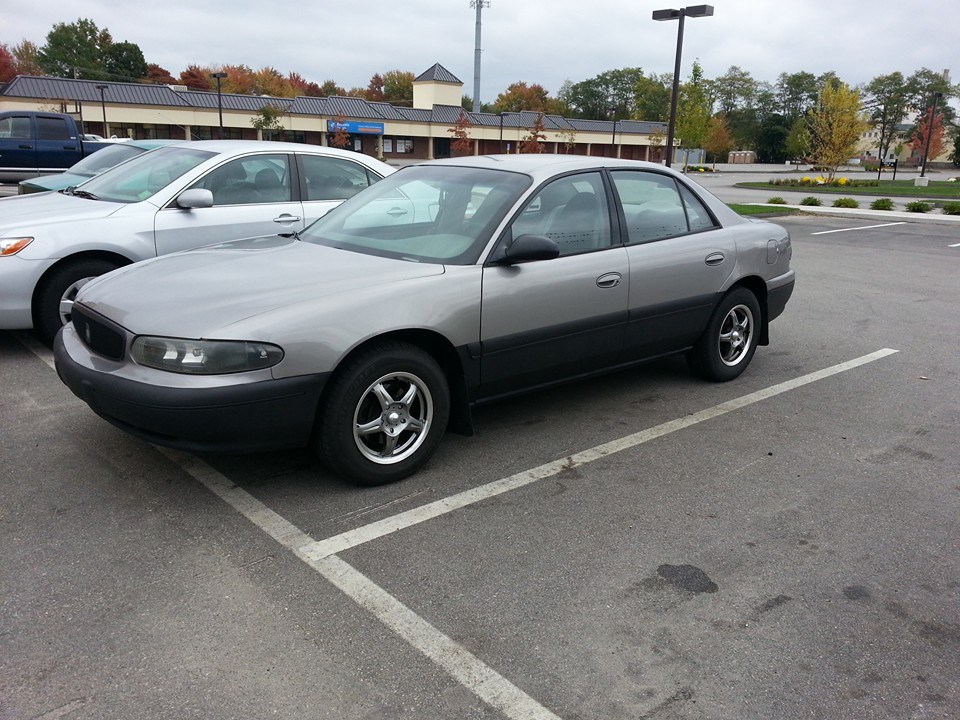

    I have a 99 Buick Century that I'm getting ready to do a LIM gasket repair on. While I'm in there, I was just going to do the head gasket too just for kicks, and do a port/polish and valve job
    I was reading that the 2000+ 3100 has better flow. What would need swapped over? I saw that to do a 3400 top swap, you'd need new pistons, custom pushrods, etc, and I don't want to get into that.
