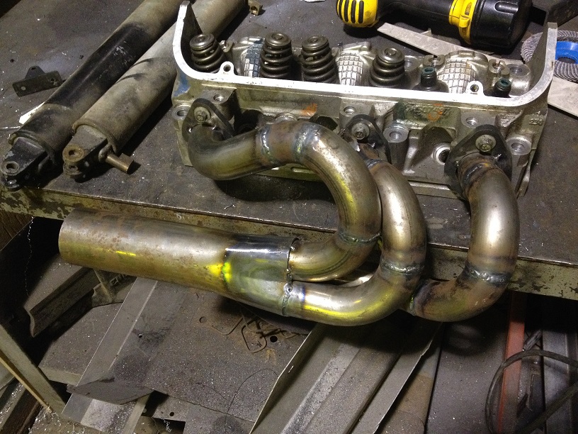

    I should have some more made... I designed mine to be different than most other offerings though. Mine weer individual for each cylinder, and not tied together.

      Did you find an advantage of the individuals over one piece ?

        Yes, I always ended up cutting apart linked flanges due to thermal expansion. I have had less issues with developing leaks using individual flanges than linked flanges.
        In the case of the gen3 660 it also meant that no modification of the exhaust gasket was needed.
        This a header from the last set of headers I built for my LX9:

          I've been running the S&S straight flange for years now with a set of stock gaskets (never used any silicon addition) only cleared for the link bars and never had any flange leaks. Granted I've also only ever run alen head cap screws and never had those loosen or fall out, I've heard of many who can't even keep in a set of locking studs. I guess everyone's experience will vary.

            Nice looking headers, how thick are those flanges ? S&S is that a brand or stand for stainless steel, got a pic ?
              S&S was a brand of headers made for the Grand Am... They can only be found second hand now. I don't know the flange thickness off the top of my head but I can measure it when I get home.
                          [ATTACH=CONFIG]8296[/ATTACH]
                          Nice, where did you buy the pipe, do you remember the diameter and gauge ?
