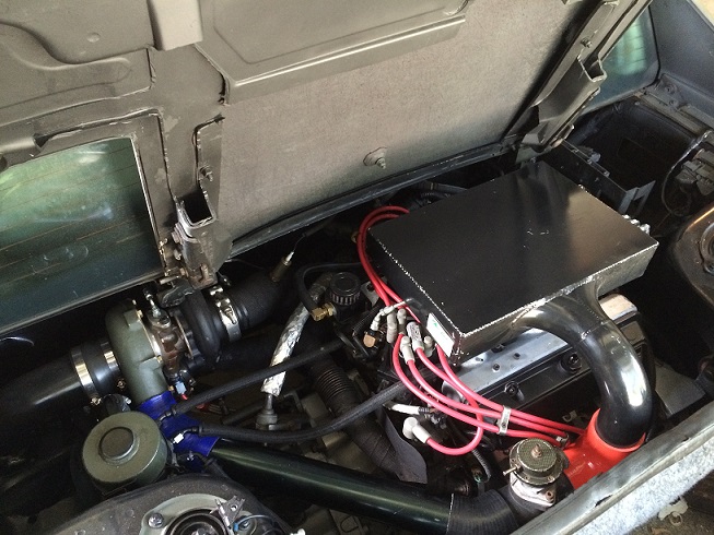

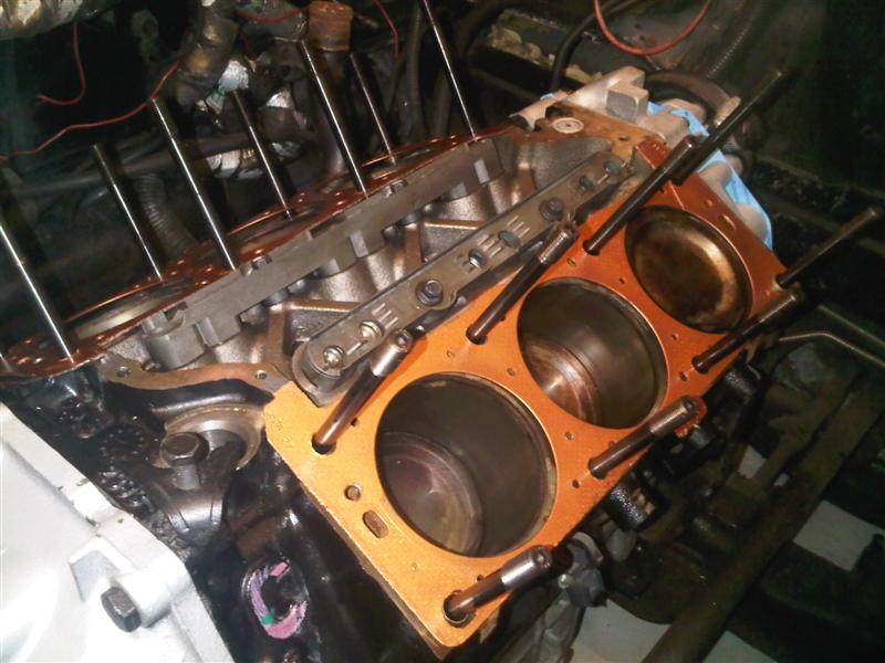

    Engine
    3500 from a junkyard approx 3k miles if I remember correctly
    stock crank (steel)
    stock rods
    stock pistons
    CR with gen 2 heads yields 10.8:1
    WOT camshaft 280.6/283.8 duration seat to seat, 225/227.6 duration @.050", .565/.526" lift w/ 1.5 rockers, 111 ICL, 111 LSA
    Heads
    GM gen 2 aluminum heads
    Katech ported; 223 int, 168 exh cfm at .500 lift
    Crane Gold race 1.5 rockers
    Custom length pushrods.
    Schneider dual valve springs
    Titanium retainers
    Modified gen 2 valve covers for breathers/oil fill

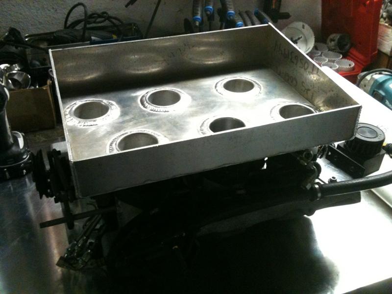

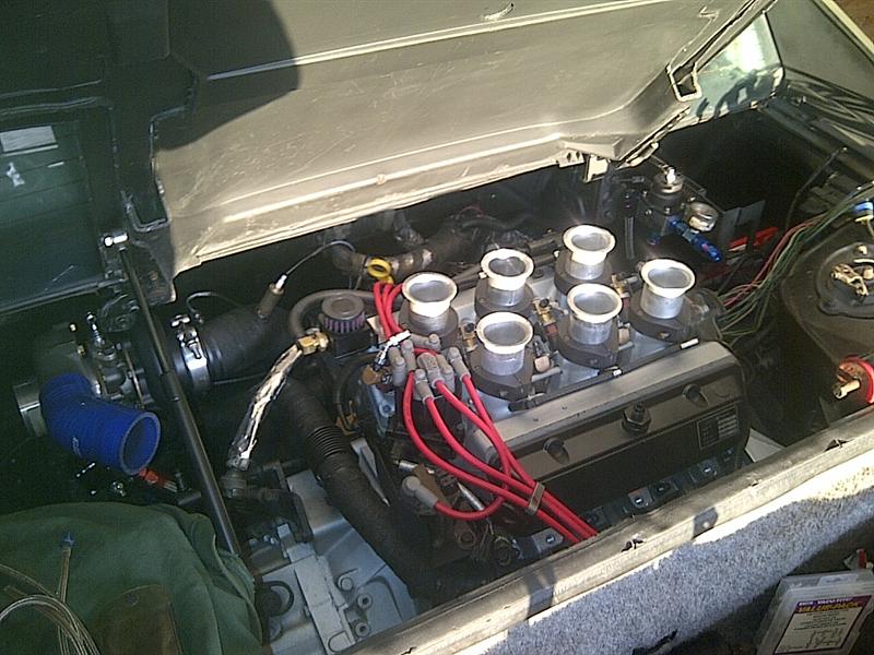

    Intake
    Custom cast ITB setup modified for EFI
    Custom sheet metal aluminum plenum (350ish ci)
