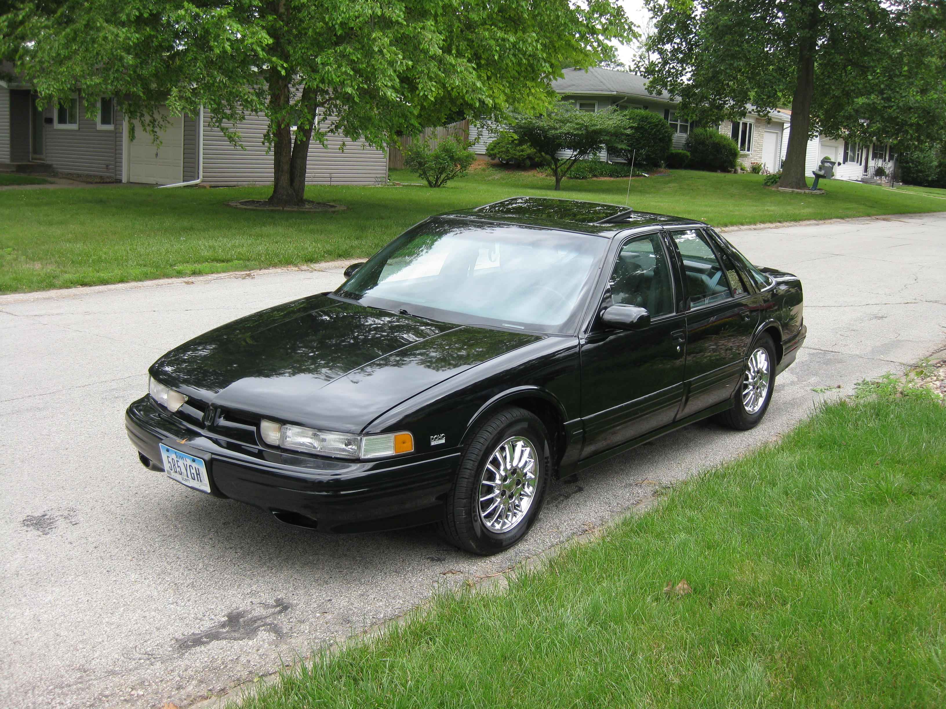

              95 cutlass HUD. Project
              [QUOTE=3100 MPFI;329061]You can put the HUD into anything you want as long as you have the patience to get it in there and looking good. As far as wiring goes, the cars are all pretty much the same in the wiring aspect.
              I put a 2000 Grand Prix HUD in my 1995 Cutlass Supreme, and it works great. The Cutlass Supreme was not designed to have a HUD, so it had to bre custom installed.
              This last one is the 2000 HUD in my 1995 Cutlass Supreme. In the first pic, you can see that the HUD UNIT is mounted UNDER THE DASH, and the dimmer is integrated into the headlight switch. The image is also smaller than the other two. The RADIO DISPLAY is not compatible with the OLDSMOBILE BOSE radio that I have in my 1995 Cutlass Supreme.
              Glad to find this thread. I thought there had to be someone else trying to do the same thing. I have 1995 Cutlass that I want to put HUD in. I pulled hud/switches and 4 foot of harness from 95 grand prix. I noticed the GP has holes for the tabs to attach the HUD. Any pointers would be great. Do you know if the DIC would work with the cutlass? I was thinking about even switching out dashes... I have the car torn apart to do L26 swap. Thanks.Click image for larger version
