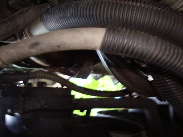

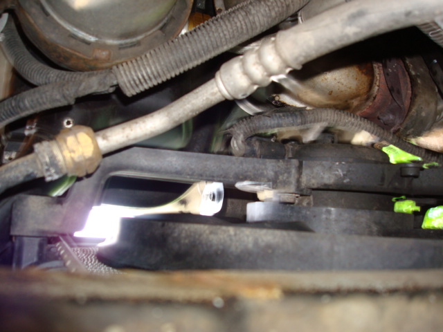

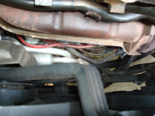

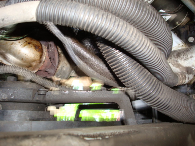

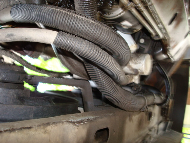

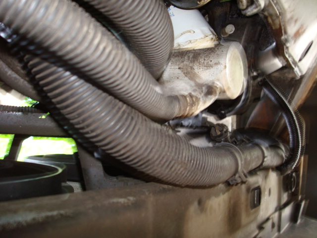

    I put the donor 3.4 into the GP yesterday but for some reason the wiring running along the radiator support just doesnt seem right. Can someone take a pick of down in between the radiator and front of the engine, on the trans side? I need to see how its routed around/under/over the A/C lines and trans cooler lines.

    I took these pics for you- perhaps they will help

      here's 3 more

        Thanks a ton, those are exactly what I needed!
