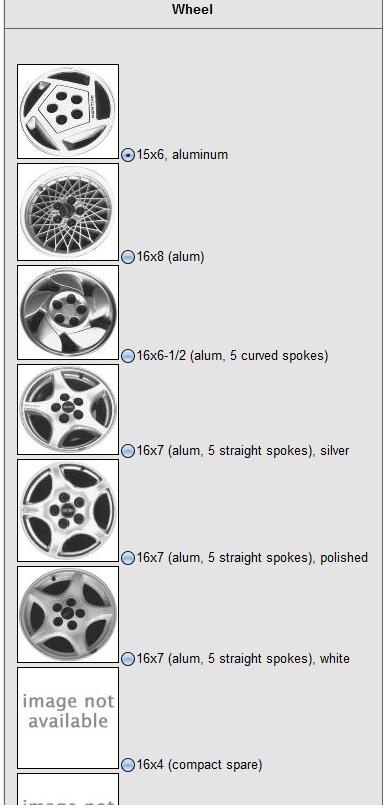

    how wide are these and how much do they weigh w/out a tire?
    i think they are 16x8 b/c u can put 245/50's on them which i thought designates a 8 inch wheel.

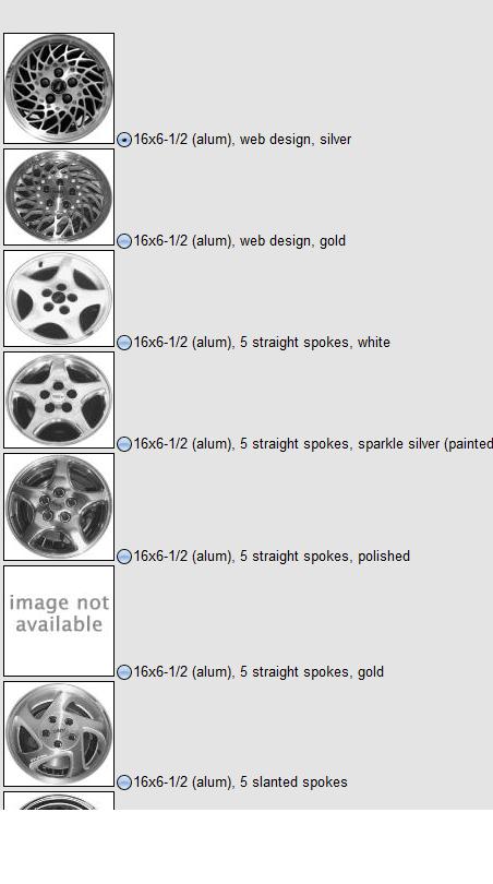

    the 16x8's are the crosslaces until 96 im pretty sure the 5 star ones are 16x7 until 96 too after that they are 16x6.5
    the pic on the left is 96 and the one on the right is 97
