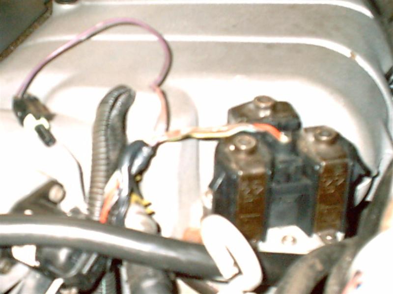

            Well, for now here's a pic taken with my pathetic camera,,,, doesn't take a good flash... My friend took a couple with a good camera, but hasn't emailed them to me as of yet. When he sends them I'll post them if needed.... As you MAY be able to see I stripped back the casing. That wire is purple, is a single wire and DOES seem to be part of the harness, doesn't seem to be spliced in as far as I can tell.. The rubber seal is green in color.. As stated previously,,,, the original motor does NOT have this wire... I doubt that I need it hooked up... Guess I'll find out tomorrow when I try to fire it up...
            Any ideas about it????
            Thanks,
            Tom

              That sure does look like an O2 sensor plug end. Your coolant sensors are all plugged in?

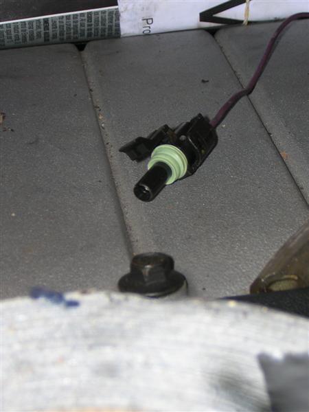

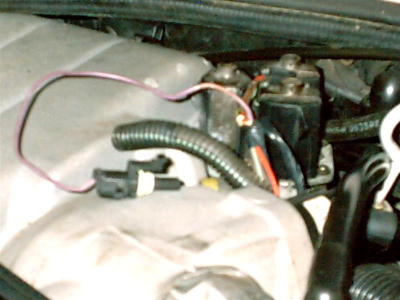

                As far as I know everything is plugged in.. The O2 sensor is plugged into the plug that comes from the trans harness,, like original... The coolant sensor, green wire, under the LIM, trans side is also plugged into it's mate on the front of the engine. The original engine does NOT have any such wire!! Here's a couple of better pics.

                  What color is the wire you plugged into the O2 sensor? Looking at 92 and 94 wiring diagrams for a DOHC, the only purple wires are O2, TCC brake switch and VSS.

                    Brad, the wire I plugged into is purple also. It's the one that the O2 sensor on the original engine was plugged into... My buddy asked me if it might be something to do with if the donor was a California car.... I have no idea if it is... Is it possible that Cali cars used a 2nd O2 sensor???? I looked pretty close at the original engine's harness tonight... There is NO purple wire anyhere near that side of the engine.... Tomorrow I'll be firing it up... I have no doubt it'll be fine,,, just curious what it is tho....

                      I ran into the same issue when I did my engine sawp way back, My car is also a 93 and I reember there being a purple wire there with the org engine and when I put the new engine in i had to run a 02 wire from the computer back... does this mother your putting in have an oil cooler If so Its prolley a 92

                        looks like an old 1 wire 02 sensor plug to me

                            That wire is for a special unit called a "smog pump" and is part of California Emissions laws.
