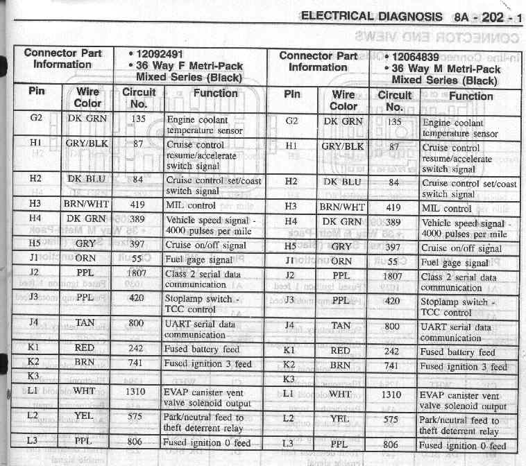

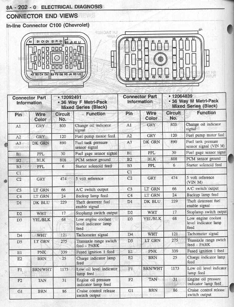

    I am currently doing my swap on my 94 and need some help from the guys that have done this swap. Shane(redzmonte) has helped me out a ton, but since he has a 95 the wiring is a little different. I have the Gm book with all the wires from teh C100 connector, but there are a few that are different from 94-95-96. Please help me if you can. Also on my 94 I have a two wire ALT, black and brown, on the 95-96 its a one wire , red. Anyone know why this was changed and what I need to do to make it work. Both ALT's are the same.
    Here is what I have
    I will post soon

      As you can see on the 94 does not have
      -B2,B3, D2,E1, F1, G1, H1, H2, H5, J1,L2,L3.
      I think that H5 from 94 has to be switch to B2 on the 96. From the 96 E1 needs to be switched to A3.
      I dont know what to do with the others? Any one have any ideas.
      • d.o.h.c
        • Jun 2004
        • 981
        It looks like alot of them that are not active from the 96 are blank on the 94, such as,
        b2,d2,e1,f1,h1,h2,j1
        -I am wondering what G1 from the 94 goes to on the 96
        -You need to add 12v constant to L1 for the 96
        -You need to switch E1-A3 for the 96
        - Is L2 on the 96 the same as the B3 on the 94?
        • d.o.h.c
          • Jun 2004
          • 981
          The B2 on the 96 harness is INCORRECT. I need to do some research and find out what pin the cruise control wire is.
          • d.o.h.c
            • Jun 2004
            • 981
            ONe wire that I need is the 96 cruise control wire, color and position on the C100. Also I looked up the ALT wireing and I have a brown and bown and white on my 94. On the 96 its a red wire and in the book it says that the 94 and 96 have 3 wires, brown, red, brown and white, so WTH
