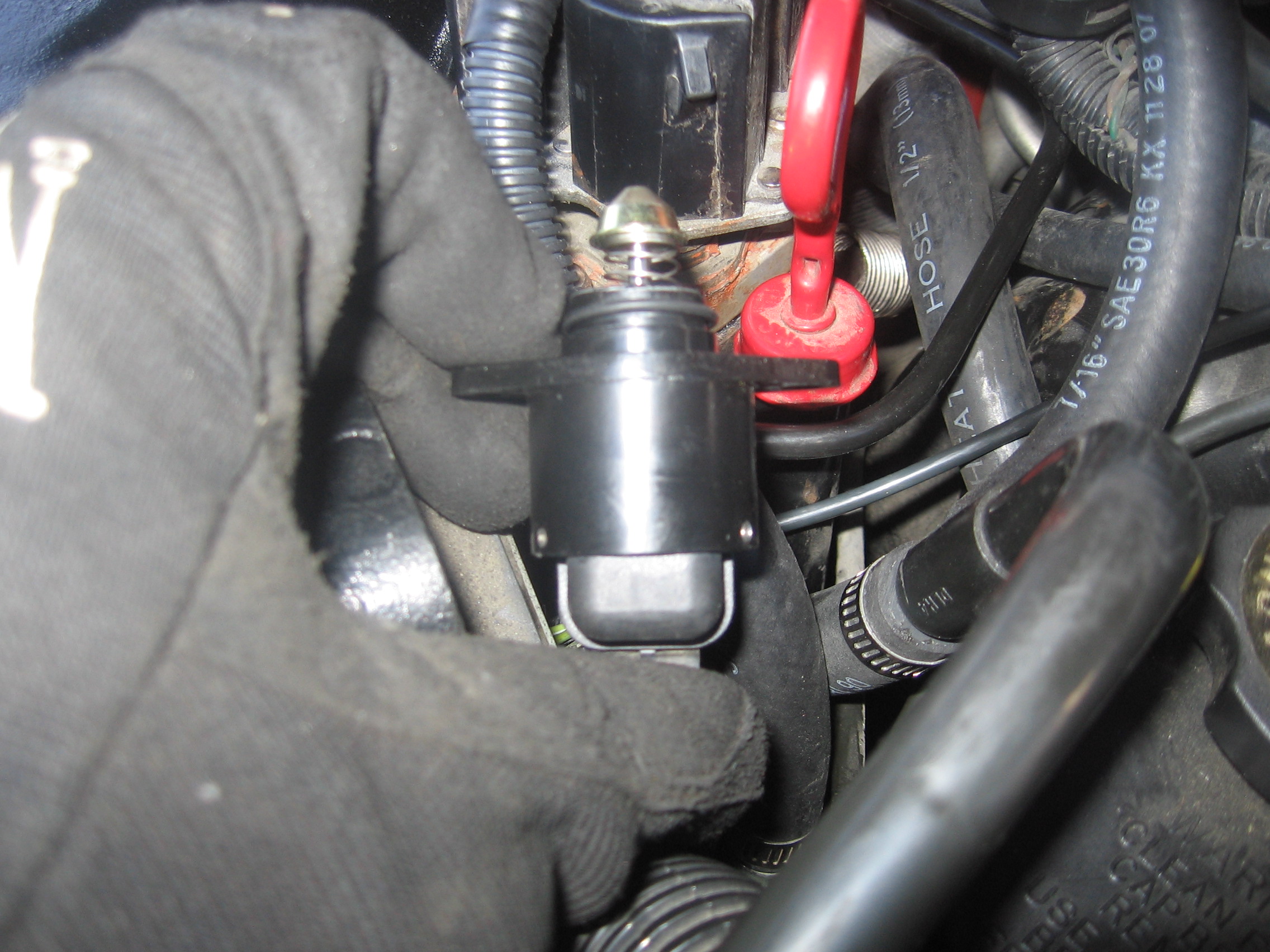

                  ok here's a pic of the IAC. It seems to be open and stuck that way. I pulled on it a little, but it feels like it might break if I pull any harder. i'm a little confused as to why it wouldn't be working

                  • walterdude
                    Destroyer Of ALL THINGS!!
                    • Feb 2006
                    • 265
                    Well this what Haynes (somewhat edited) has to say about replacing the IAC.... This is the process I used when I replaced the IAC on my 93 Z34.... It worked for meE!!!
                    Hope this helps....
                    Tom....
                    It says NOT to push or pull the pintle,,, it could damage the threads on the worm-drive...
                    "-Before installing a new IAC valve assy, the position of the pintle must be checked.
                    -Measure the distance from the gasket mounting surface of the IAC assy to the tip of the pintle.
                    -If the distance is greater than 1 1/8" reduce it by applying firm hand pressure on the pintle to retract it.
                    Note: the IAC resetting is controlled by the ECM. To initiate this process turn the ignition on for 5 seconds,,, turn it off for 10 seconds,,, then start the engine and check for proper idle..."
                    • 55trucker
                      • 213
                      There will be resistance to your attempt to manually move the pintle....the motor & pintle arm is a worm gear design.....here's where some voltage applied to the motor is needed to move the arm.... you can see in the wiring diagram that the control is a double pole double throw application that moves the motor. You have applied voltage in one direction for both circuits that moves the pintle in one direction and to reverse the direction the voltage is reversed. You can literally do the same with a low voltage applied to the motor contacts to get it to move. This particular circuit is so much easier to diagnose if one has access to a scan tool ....but that's something we don't all have in our back pocket..

                      • 55trucker
                        • 213
                        I did come across another note in my Chiltons manual (the GM manual is rather rigid and not always as flexible as the after market)....*Quote......No physical adjustment of the IAC valve assembly is required after installation. The IAC valve is reset by the ECM when the vehicle is driven at a speed ABOVE 30mph or when the diagnostic test terminal is grounded while the engine speed is above 2000 rpm*.....I had to dig this manual out (I don't use it too much)...but there's another route you can try to see if the IAC is actually working.

                        • lvbroham1
                          • Jan 2009
                          • 20
                          ok, i played with it a little before sundown. I took my old sensor and put it in when it was fully extended, the car wouldn't start, so i'm guessing I don't have a vacuum leak. I did the reset thing about 4 times and no luck, so tomorrow I will take her out for a drive and see if this settles the whole idle issue. I appriciate all the help guys, and i'll let you all know if this works or not tomorrow.
